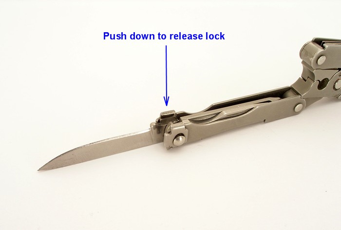

M4 Sebertool lock release
Blade lock release

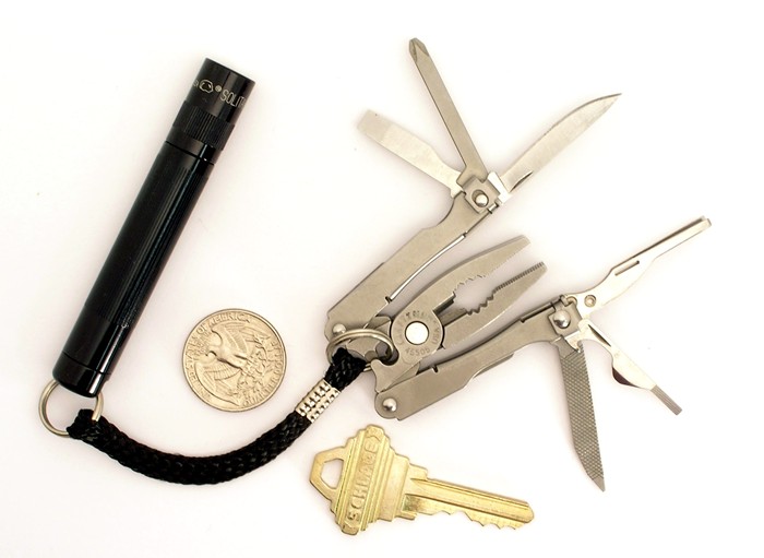

Blades and Tools
As stated above, all the blades are outside-opening, and all blades lock open. There are three blades in each handle:
  • knife blade, with double edge V grind. 1-1/2" long (35mm)
  • medium Phillips screwdriver
  • medium flathead screwdriver
  • two-sided file blade. Single cut and double cut serrations
  • combination eyeglass screwdriver/bottle opener
  • tweezers

Blades lock open via a backspring tab that engages a notch in the blade. Lock release is accomplished by pressing down on a small tab. (see photo)

The M4 is able to quickly attach or release from a key ring, by means of a hole on the opposite side of the plier jaws. Securely closed up, the tool is quite unlikely to accidentally release from a key ring or lanyard loop.
