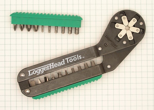

Loggerhead Immix 20X
fully closed

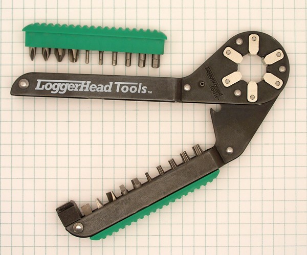

fully open

The Immix 20X uses the patented Bionic Wrench principle of adjustable jaws. Opening and closing the handles causes a series of cams to drive six individual jaws. Operation is quite smooth. Capacity of the jaws ranges from 7/32" up to a max of 9/16" (6mm to 15mm) Note that the bionic wrench requires considerable clearance in order to access a nut or bolt.

Two removable rubber bit carriers, each with ten standard 1/4" bits fit securely into each handle. These bits can be driven either with the bionic wrench, or with the bit receptacle in the far end of the tool. (see photo) A magnet holds keeps the bit from falling out of the bit receptacle.
