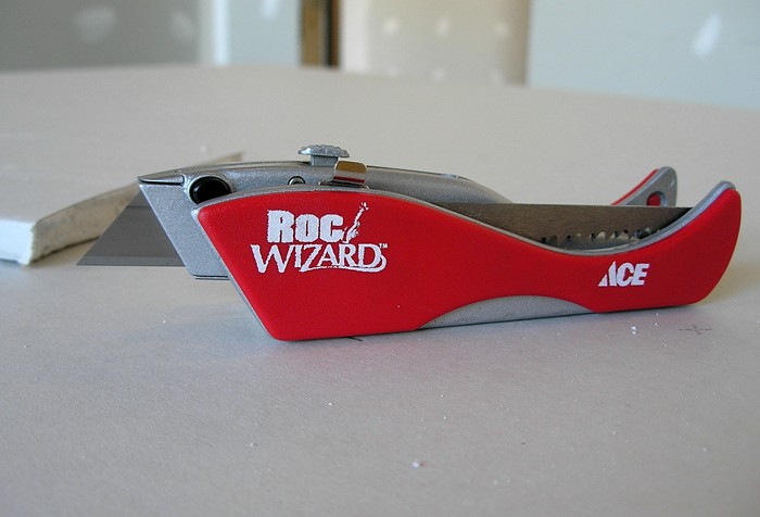

Side View |

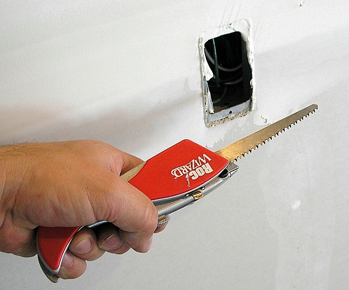

Locking Saw Blade |

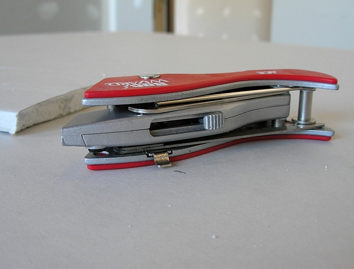

Handle/Frame
The frame of the Roc Wizard consists of two slabs of cast zinc (or aluminum?) held together by several cross pins. Rubberized grip panels with a variety of printed logos are attached to the sides. Overall size is a considerable handful.Blades

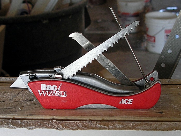

- Primary blade is a standard utility knife, including the entire full-sized handle. The razor blade itself is extended and retracted using a locking push button.
- Saw blade, which locks open with a standard liner lock.
- Tube punch, intended to pierce the seal of caulk tube containers.
- Screw pry bar.
Locking Mechanism
The saw blade locks open via a standard liner lock. A release tab sticks up above the handle.The razor knife blade locks open at three different lengths using a standard utility knife mechanism.

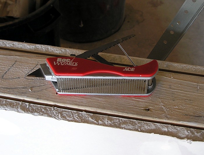

Other Features
A drywall rasp is located along the bottom surface of the Roc Wizard.Sheath

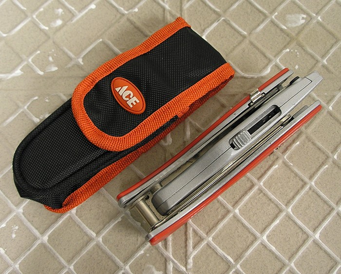

A floppy nylon pouch is included with the tool. It utilizes a velcro closure. Loop on backside is suitable for vertical carry only. Logo on pouch varies depending on brand.Dimensions

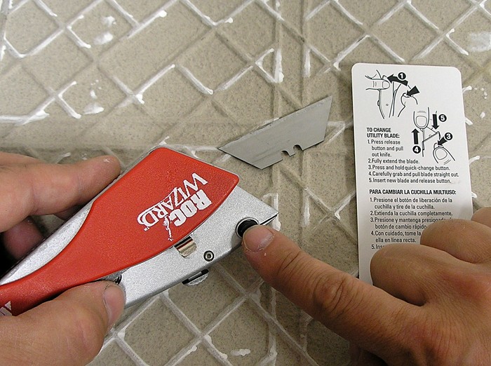

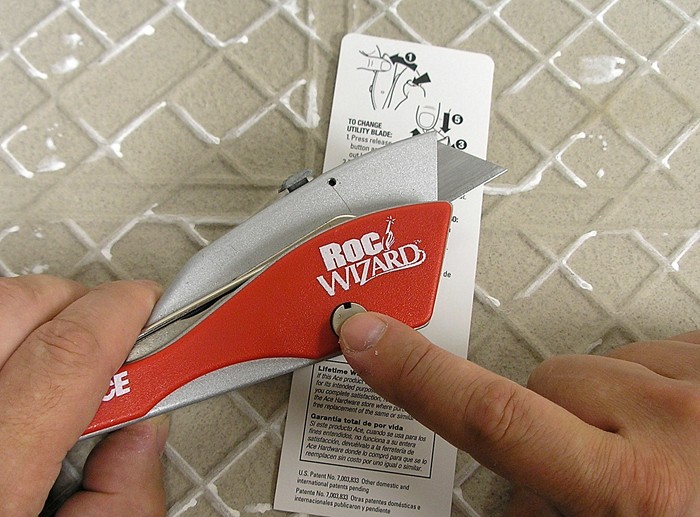

Replacing The Knife Blade
A spring loaded cross pin locks the utility knife handle in place. Pressing a side button allows the knife to be pivoted upwards. (see left photo below) With the knife in this position, press the black button to release an exchange the razor blade. (photo on right below)Variations
