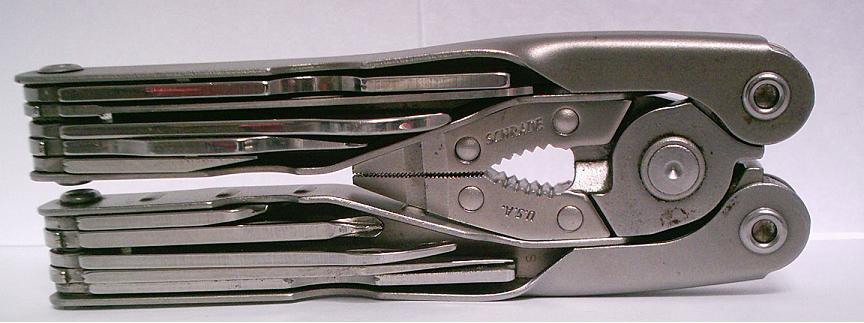

ST1 sideways, closed
Series 2 ST1
Schrade ST1 sideways closted, tool view
Series 2 ST1

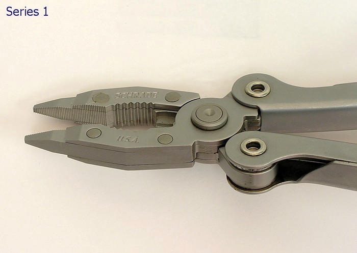

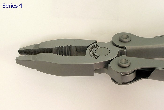

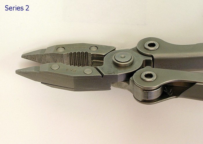

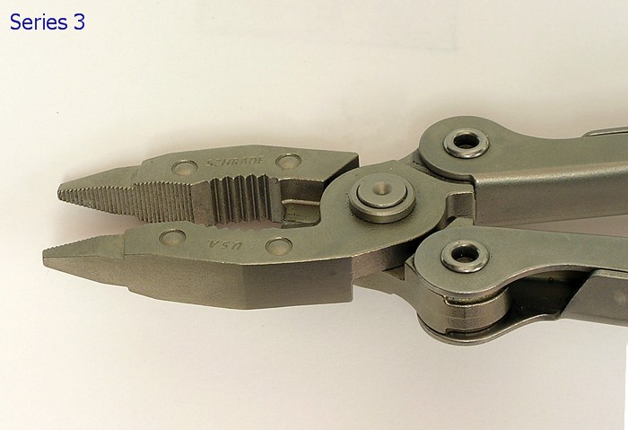

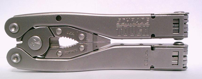

ST1 plier heads ST1 plier heads ST1 plier heads ST1 plier heads
Jaws
Jaw construction evolved over the years. See VARIATIONS below.
Profile is an unusual stepped needlenose. Fine and coarse serrations are included, along with a bypass wire cutter. No hard wire notch.
Handles/Frame
Handles are bent in a complex shape, forming a complete rectangular tube at one point.
All pivot points are rivets, not screws.
Finish is matte bead blast stainless all over.
The SCHRADE TOUGH logo is stamped in one handle, patent info in the other. No inch or metric scales are present.

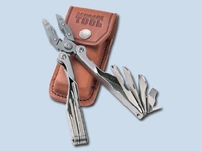

Sheath
Two sheath options were available standard: Heavy leather with snap closure, and woven nylon with velcro closure. Vertical or horizontal carry.

Over the years the ST1 continued to evolve as manufacturing methods changed. Most dramatic differences can be seen in the plier head (see pictures at right) and the blade selection.
