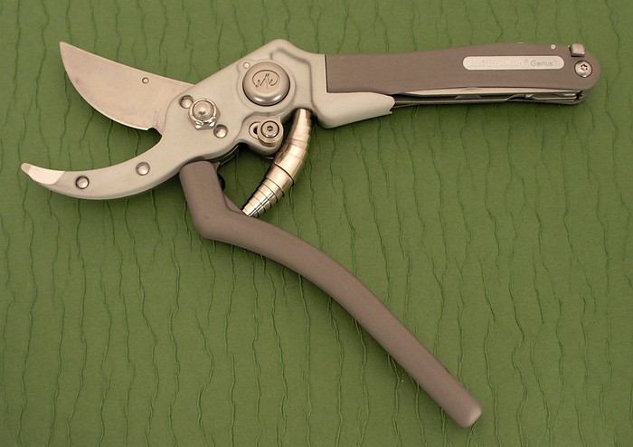

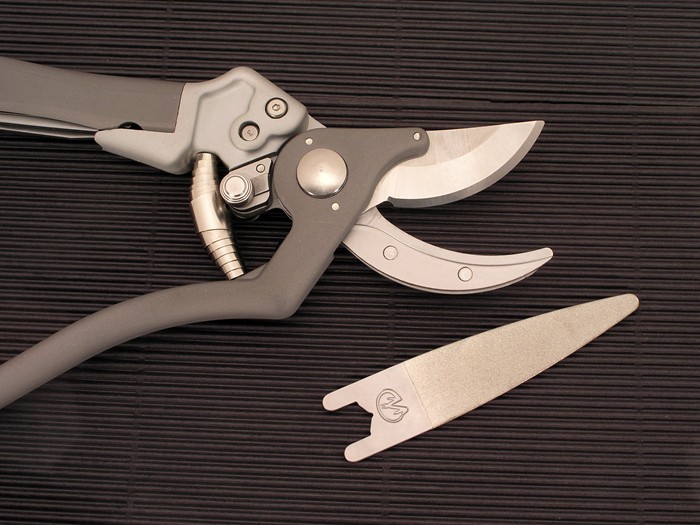

Jaws
The cutting jaws consist of two slabs of precision ground and hardened stainless steel. The lower jaw is riveted to the aluminum frame. The upper jaw is held in place by pins, and is easily removable for sharpening or replacement.In addition to the razor sharp pruning edges, there is a soft wire cutting notch in near the pivot.

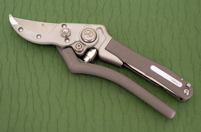

Handles/Frame
Handles and frame on the Genus are very strong, made from solid cast aluminum.Depressing the large button on the side of the frame allows the upper handle to rotate. This gives the user ready access to the blades and tools housed within.
A sliding safety lock button locks the pruner jaws closed when not in use. It is accessible on both sides of the tool. (ambidextrous)
A decal inlaid into the side of the handle is marked LEATHERMAN Genus.
There is no date coding on the Genus.

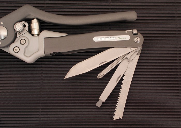

Blades and Tools
All the blades and tools lock open.- Clip point knife blade with plain edge. Measures 3" long. (77mm)
- Phillips screwdriver with square shank
- Combination medium flathead screwdriver/sprinkler head adjustment key
- Saw blade

- A double-sided diamond file is included with the Genus. It has a wrench on one end with which to disaasemble the tool.
- Upper blade is removable/replaceable
- Mainspring is removable/replaceable
- Locking nut on the jaw pivot bolt can be tightened as needed to maintain proper fit between the jaws

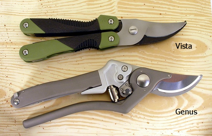

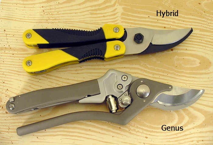

Announced by Leatherman in 2007, the Genus was not generally available until later that year. Made in the USA. Discontinued in 2010.Related Tools
Although they are altogether different in construction, the Hybrid and Vista are other pruner multitools produced by Leatherman around the same time.More Info
