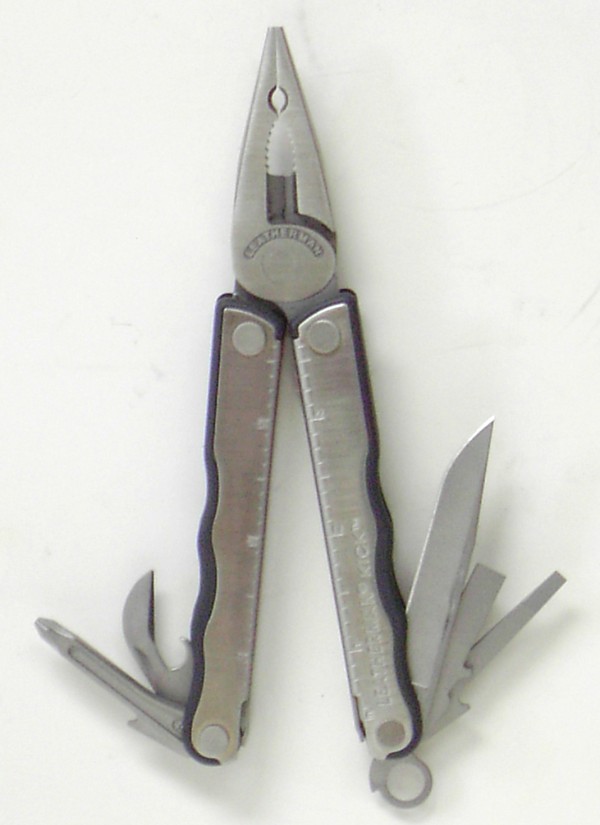

Leatherman Kick 2004 saw a major reshuffling of Leatherman's multitool lineup. Gone were the traditional PST, PST II, and SideClip. In their place were the new Kick, Fuse, and Blast. Zytel plastic inserts for a more comfortable grip and a plier head re-engineered to be stronger are the most notable changes. The Kick model has the fewest features of any tool in this group.

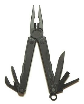

Leatherman Kick, black oxide
black oxide finish

Jaw shape is standard needlenose, but the elliptical pivot area appears to be significantly stronger than previous Leatherman tools. There are fine serrations running out to the tips, a gripping area below that, and a wire cutter area near the pivot. A hard wire cutting notch is also included.
One whole side of the plier head on the Kick is ground flat, apparently to allow space for the knife blade when the tool is folded. This makes the Kick pliers slightly thinner than they would be otherwise.

Along with the Fuse and Blast, the Kick was the first tool from Leatherman to feature contoured Zytel plastic inserts for a more comfortable grip. It can be assumed that the plastic inserts add somewhat to the sturdiness also, as the gauge thickness of the stainless steel handle material has been reduced somewhat from previous models.
An inch scale is stamped onto one side of the Kick, a metric scale on the other.

None of the blades or tools lock open.
  • Plain edge knife blade, with clip point. Measures 2-5/8” (66mm)
  • Small flathead screwdriver
  • Medium flathead screwdriver
  • Folding lanyard ring attachment
  • Combination wire stripper/can opener/cap lifter
  • Square shank phillips screwdriver

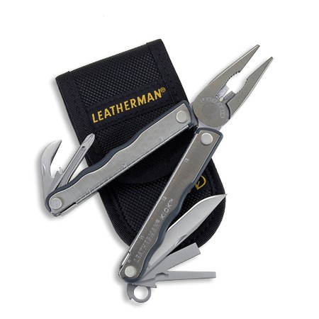

Two options existed for included sheaths. One was a pancake nylon affair with velcro closure, pictured at the top of this page. The other was rectangular in shape, with a snap closure, made from a leather-like substance.

  • Standard stainless finish
  • Black oxide finish
  • Stainless, with cap crimper jaws
  • Black oxide, with cap crimper jaws

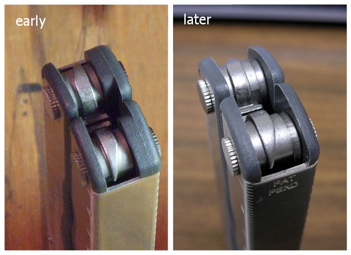

Earliest Kicks had a double-wide plastic boss to fill in space alongside the plier head. Later models used a stainless steel washer.
