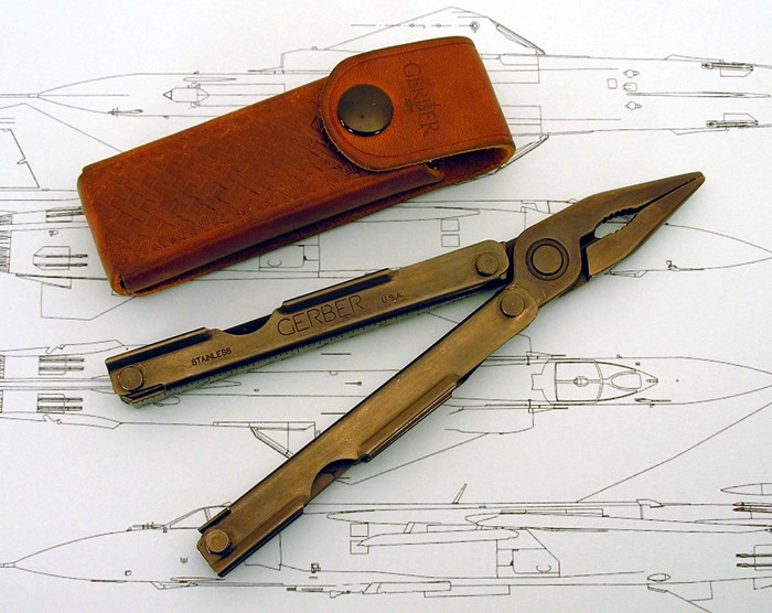

MPT, black oxide
Black Oxide version

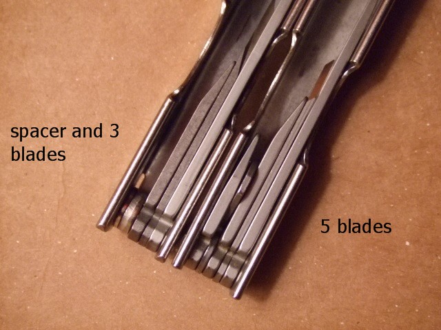

3 blades -vs- 5 blades
Blade variations

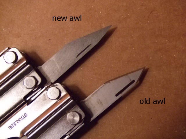

new -vs- old awl
Awl variations

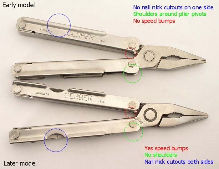

Handle Variations
Handle variations

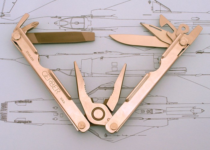

Jaws
As the MPT was Gerber's only butterfly opening tool for many years, its jaws do not resemble those of any other tool from that company.
Jaw features include fine serrations, a gripping area, and a wire cutter area. (No hard wire notch is included.)
Early models had a brushed stainless finish. Later models were matte polished.

Blades and Tools
  • Plain edge knife blade, drop point profile, double side grind bevel. Measures 2-1/2" long. (63mm)
  • Large triangle awl blade
  • Combination can opener/small flathead screwdriver
  • Folding lanyard ring
  • Large flathead screwdriver
  • Simonds three-sided file blade
  • Phillips screwdriver with square shank
  • Combination cap lifter/medium flathead screwdriver
Blade Characteristics

    • Some tools have blade selection as specified above. Other tools lose the lanyard ring and the large screwdriver, substituting a spacer washer or two in their place. (see photo at right)

  • Awl blade
    • Large triangle awl had slotted nail nick. Later awls had notched nail nick, and sharpened bevel edge was reversed. (see photo at right)

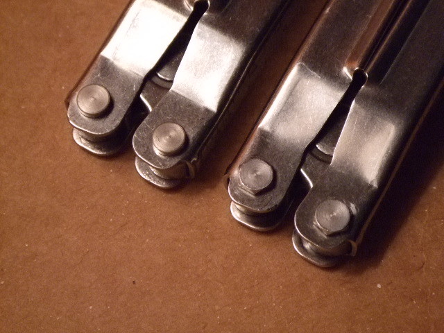

  • Pivot screws
    • Some tools have hex bolts in all locations. Other tools have hex bolts for blade pivots, round headed bolts for plier pivots. (see photo at right)

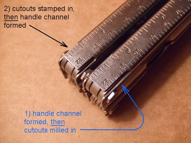

  • Handles - there seem to be three variations:
    • Nail nick cutouts only on one side, "shoulders" near plier pivots, no "speed bumps" near plier pivots, long stamped-out reliefs for blade backsprings.
    • Nail cutouts on both sides, no shoulders, yes speed bumps, long milled-out reliefs for blade backsprings.
    • Nail cutouts on both sides, no shoulders, yes speed bumps, short stamped out reliefs for blade backsprings.
