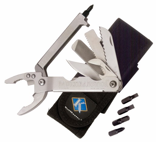

MultiMaster blunt nose The MultiMaster tool was one of the first multitools to go up against the then newfangled Leatherman PST. Manufactured by Kutmaster, an old time cutlery company from Utica New York, the tool has the crude yet rugged construction of the late 1980's. Almost thirty years later it is still listed in the company's catalog, virtually unchanged.

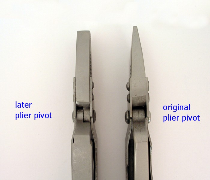

MultiMaster plier pivots
new and old plier pivots

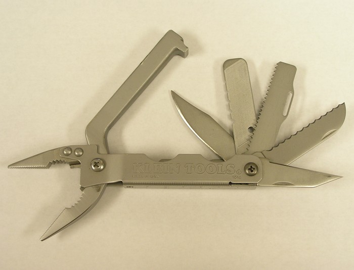

Klein Tripsaver 1016
Klein 1016

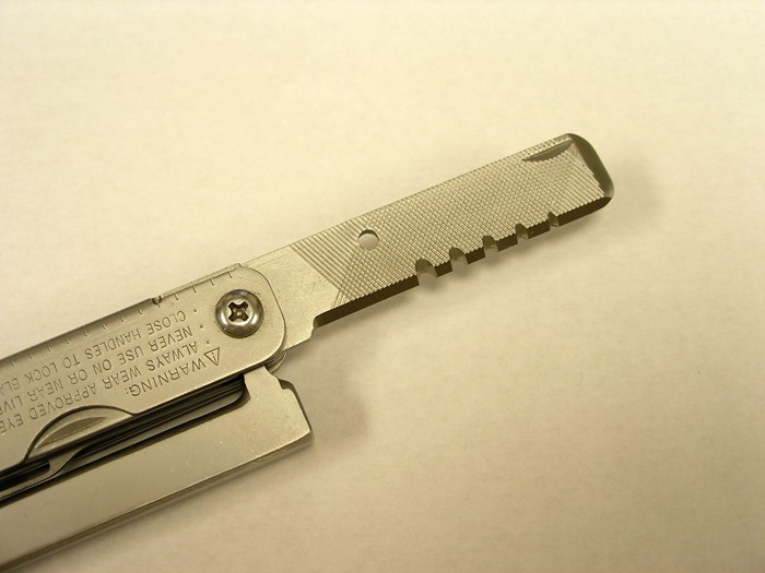

Klein wire stripper file

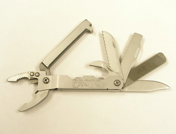

Proto 18575
Proto model 18575

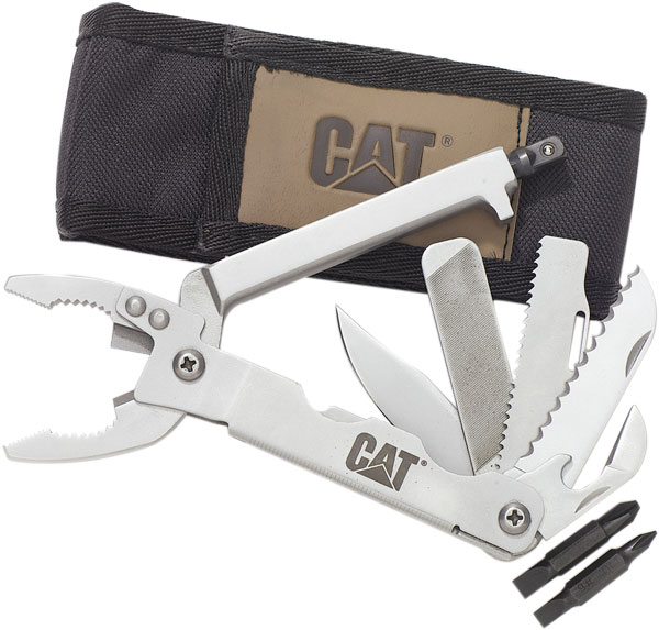

Caterpillar
Caterpillar

Plier jaws were offered in two versions: needlenose, and blunt nose. Both models have fine serrations near the nose, a gripping area below that, and a bypass wire cutter area near the pivot. (No hard wire notch is included)
Being a "solid handle" design, one jaw is an integral part of the plier handle, while the opposite jaw is pinned to the frame with two rivets.
Handles/Frame
The plier handle is a single piece of cast steel. It has a hex bit driver in the end, and a "Locking L" tab to engage the blades.
The frame is a piece of sheet steel folded into a channel shape. One side is stamped MULTIMASTER in large font. In smaller font it says BY KUTMASTER and USA PAT PEND. An inch/metric scale is stamped on the bottom side.
Finish is bead blasted stainless all over.
The plier pivot and blade pivot are rather unusual in that they use Phillips head screws.
Blades and Tools
The MultiMaster has five folding implements:
  • Clip point knife blade, 2-1/4" long (60mm)
  • Two-sided file blade, featuring single cut and double cut serrations
  • Saw blade
  • Sheepsfoot serrated knife blade
  • Can opener/bottle opener
Locking Mechanism
All blades lock open using a unique feature Kutmaster refers to as the "Locking L" safety device. Once a blade is fully opened, depressing the plier handle causes a tab to engage a slot at the base of the blade. This prevents the blade from accidentally closing during use. The method is crude, but effective.
Other Features
There is a hex bit driver receptacle in the end of the plier handle. It uses a small magnet to retain the bits. (Later changed to a circlip.)
Sheath
A large, tri-folded nylon sheath was generally included with the MultiMaster. It had a pouch for carrying a kit of spare hex bits (also included) and a velcro closure.
Belt loop allowed vertical carry only.

At some point production of the MultiMaster was moved overseas. Quality of these Chinese-made tools does not differ much from USA-made tools. They can be distinguished by a complete lack of markings on the frame, as well as a poorly shaped head on the plier pivot. In addition, a new "scissors" type pivot has been utilized on the plier jaws.

  • Klein Tools:
    • The Tripsaver 1016 was produced in needlenose only.
    • KLEIN TOOLS is stamped on one side in large font. A lengthy safety message is stamped on the other side.
    • A large triangle awl blade was substituted for the can opener/bottle opener blade.
    • The file blade was unlike any other variation. It featured five different sized wire stripper notches along the edge, and a beveled grind on the end.

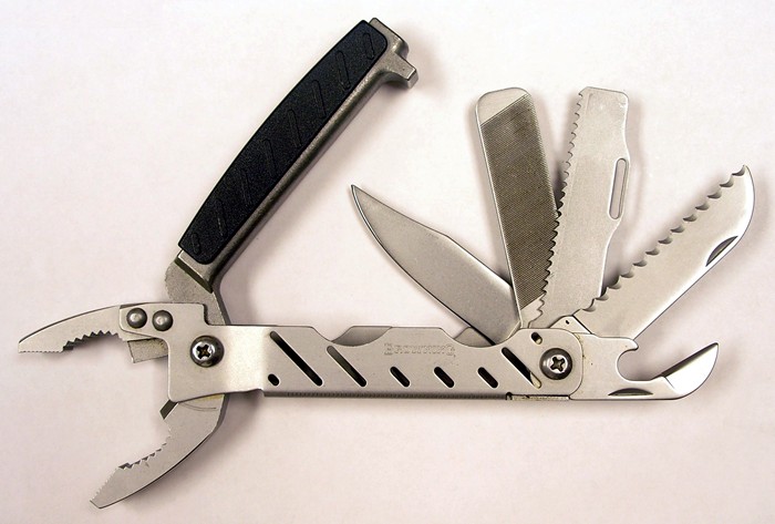

  • Browning:
    • The Model 400 was produced in blunt nose only. It was available as a component in the company's BR-400 Shooter's Tool Kit.
    • BROWNING is stamped in small font on one side of the tool. MODEL 400 is on the other side.
    • Angled "lightening slots" have been added along both sides of the frame.
    • A black plastic grip was added to the solid plier handle.
  • Stanley Proto:
    • Produced in both model 18575 blunt nose and 18576 needlenose.
    • PROTO is stamped in large font on one side of the tool.

  • Caterpillar:
    • Produced in both needlenose and blunt nose versions.
    • A large CAT logo is chemical etched into one side of the tool.
