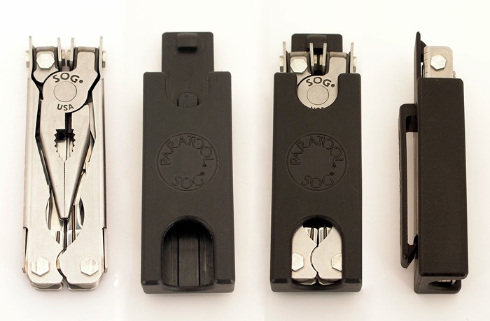

Standard sheath for the ParaTool is a woven nylon affair with velcro closure. It can be carried either vertical or horizontal.
Also available was a molded plastic carry pouch, form fitted and made especially for the ParaTool. It featured a pocket clip on the backside, with the name Blackie Collins molded in. (see photo at bottom of page)
