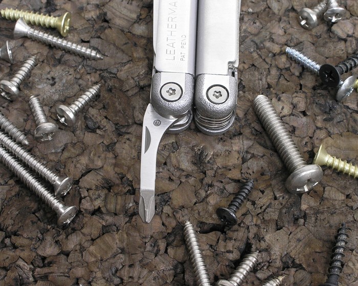

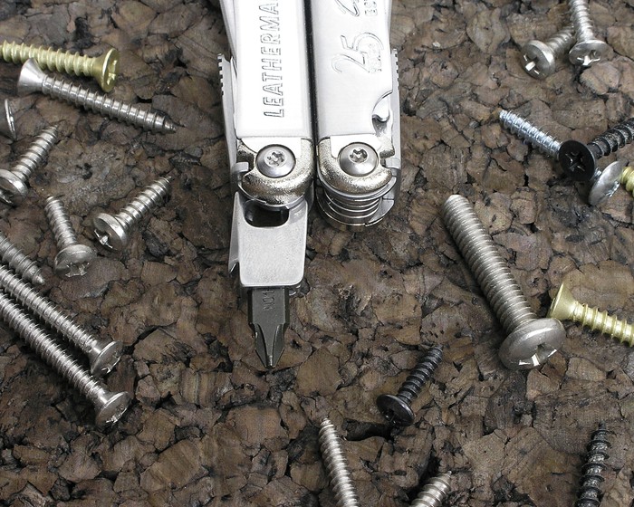

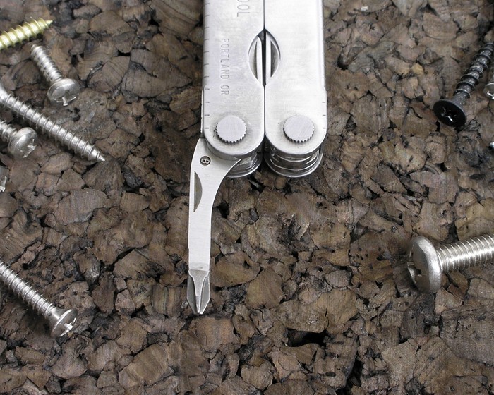

Early PST
25 years ago the first Leatherman PST's had a pretty decent phillips on them. The body and shank were polished, so it would fold out smoothly, but the head was left rough, allowing it to "grip" a stubborn screw better. The only flaw in the design of those first phillips was their tendency to fold up under pressure. Ouch!

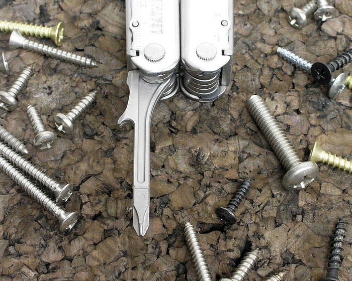

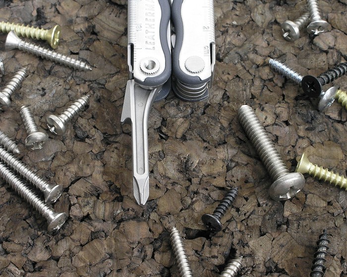

Later PST
Original Wave
Later, when the Original Wave came out, it used the same "offset" principle.

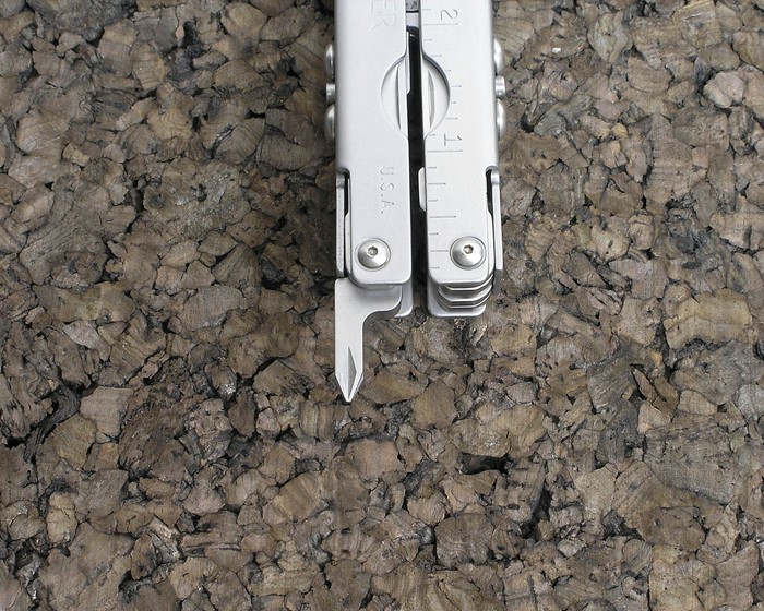

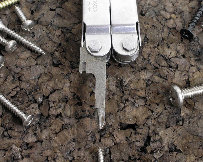

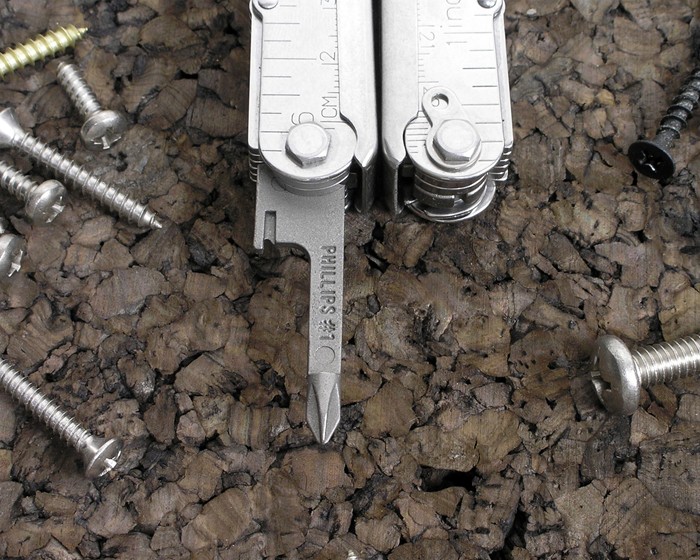

Pocket Power Plier
SOG uses a phillips screwdriver that is very similar in design to the original PST. On the old non-locking PowerPlier and Pocket PowerPlier, you can see how this design is susceptable to folding under pressure.

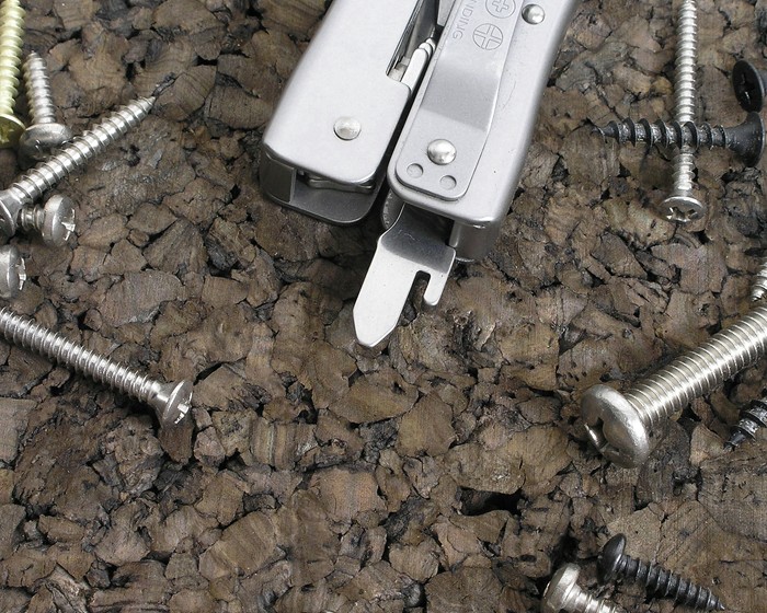

PowerLock
The phillips screwdriver on the SOG PowerLock locks open, so there is no longer a concern about fold up. For such a large tool as the PowerLock though one might expect SOG to equip it with a larger #2 phillips driver instead of the little #1. The SOG PowerAssist and PowerDuo have the same #1 Phillips screwdriver as well.

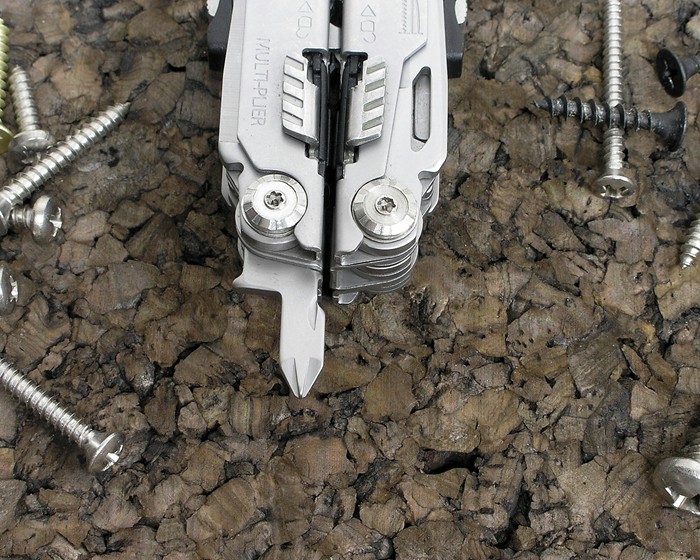

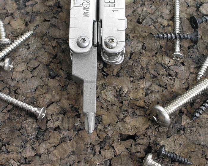

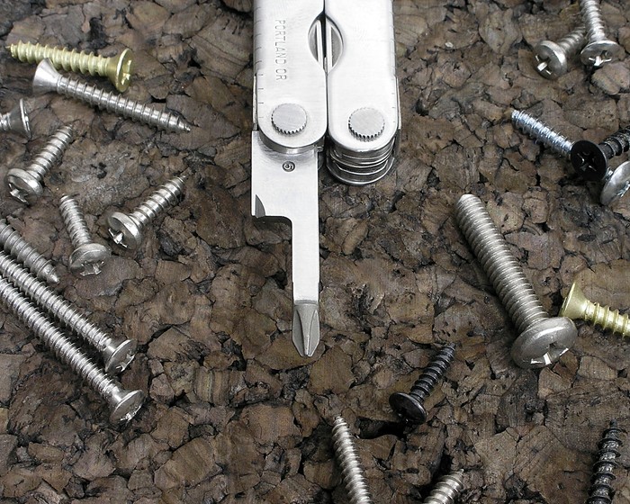

Multi-Plier
Original Gerber Multi-Plier tools came with a full square phillips. The head size was a #2, and the solid shank meant they were stronger than their competitors. Offset heads meant they didn't fold up. The downside was their short length, and the fact that the full width shank took up space that could have been used for other blades.
MP600
The next generation of Gerber Multi-Plier (the MP400 and MP600 series) addressed these concerns somewhat, giving the phillips a slightly longer reach.

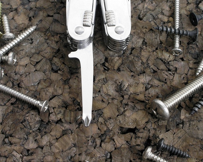

Diesel
After that from Gerber came the Diesel, and on it we see a flattened phillips driver. This allows more blades to fit in the handle, but the design does not seem to grip screws as well.

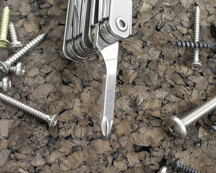

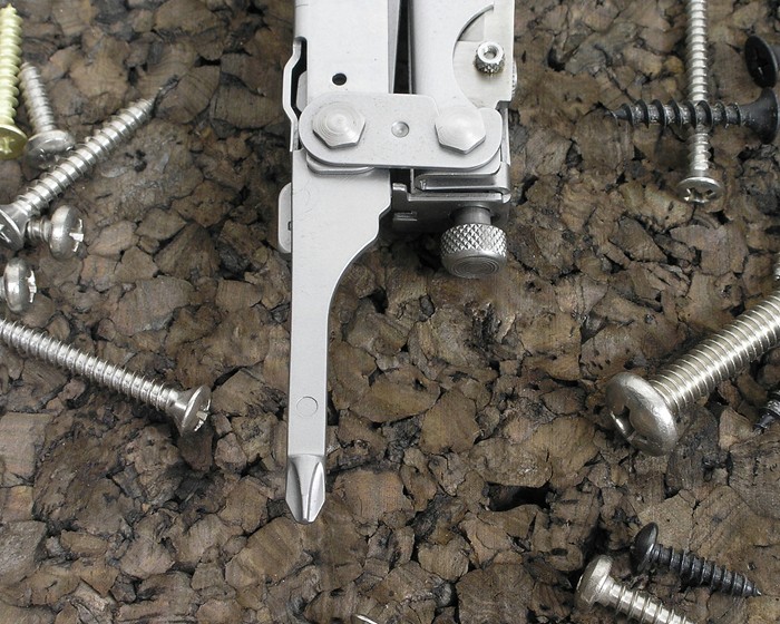

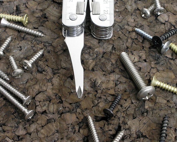

Swisstool
At Victorinox they had of course been making screwdrivers for a long time prior to the SwissTool. The phillips driver has plenty of reach, a full head, and a reduced shank. All good things. Exactly how this driver is manufactured is uncertain. It appears as if the head area has been "squashed", with the metal from the grooves being displaced out into the teeth, flaring the end somewhat.
Swisstool Spirit
A few years later the Swisstool Spirit arrived using the same proven manufacturing technique on its Phillips screwdriver.
Complaints have been made stating that the high polish on Victorinox screwdrivers causes them to slip easier on tight screws. Another observation is that the Victorinox Phillips don't seem to fit snugly in many Phillips screws. Perhaps there is some difference between European and American Phillips standards.

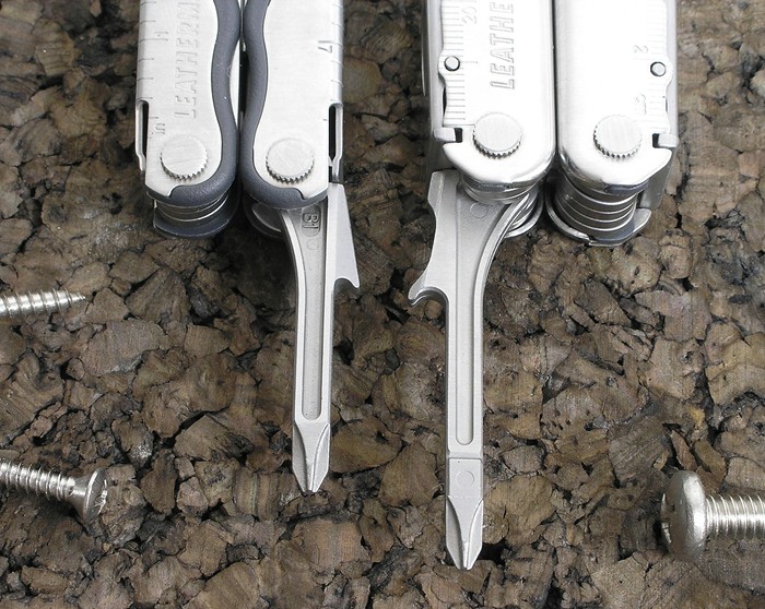

New Wave
Meanwhile Leatherman continued to innovate. When the 2004 New Wave and Charge models came out they are equipped with an interchangeable bit driver along with proprietary flattened hex bits. A variety of different bits are available. Some like the versatility this provides. Others dislike the limited reach this system restricts them to. The larger Leatherman Surge utilizes the same bit exchanger system as the New Wave and Charge series.

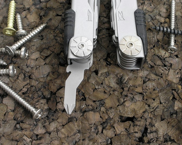

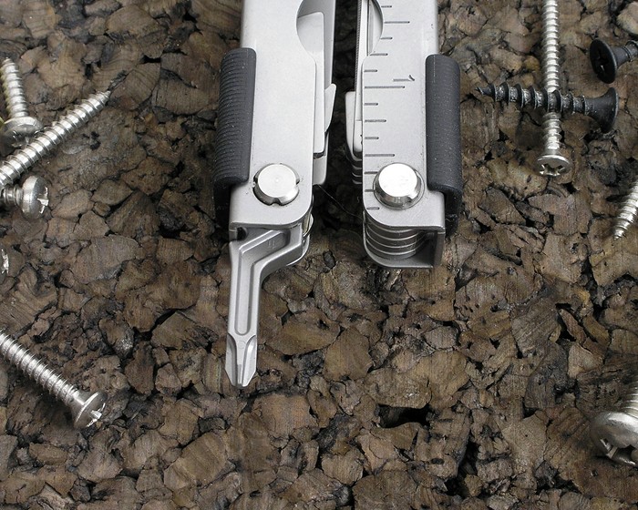

Kick
At about the same time Leatherman introduced a new generation of dedicated drivers on some of its multitools, like the one (shown at left) on the Kick. It has a good reach, a #2 head that fits into screws properly, a textured finish, and is properly offset. The same driver appears on the Fuse and Blast, as well as the newer Rebar.
Core
A similar dedicated Phillips is on the Core, except that this one is longer still. The same driver appears on the newer Super Tool 300.
Kick vs. Core

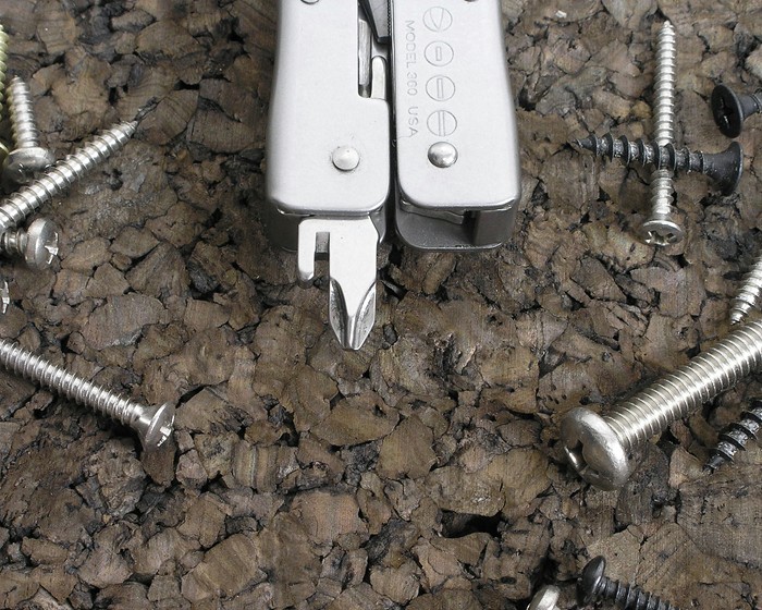

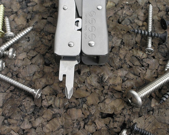

Early Bucktool 360
The BuckTool 360 originally came out with a short, three-toothed Phillips that was flat on the back side.
Backside of an early BuckTool 360 Phillips at right. Apparently this design allowed them to squeeze more blades in.
Later Bucktool 360
Later models of the BuckTool 360 have a full four-toothed Phillips. This style also has little gripping ridges on the teeth, which were intended to grab the screw better. It was still rather short in length though.
