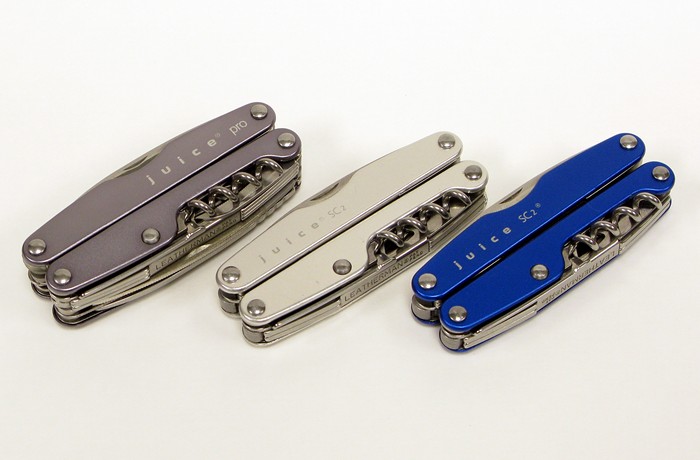

SC2 color variations
Juice SC2
Storm Grey Juice Pro-v- Clear-Silver -v- Glacier Blue

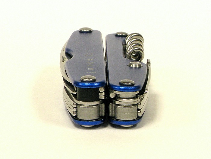

Handles/Frame
Sandwich/layer construction of the handles is more thoroughly described on the Juice Series page. On the SC2, there is a large cutout area in one handle to provide clearance for the corkscrew. On the opposite side, smaller cutouts provide easier access to the screwdrivers.
LEATHERMAN and PAT PEND are stamped along the spine of both handles.
The handles on all Juice tools are somewhat mismatched in thickness. This condition is particularly noticable on the SC2, because it has two outside-opening blade layers in one handle, but only one in the other.
Pivots
The Juice series features round head rivets for pivots instead of the traditional Leatherman knurled screws.

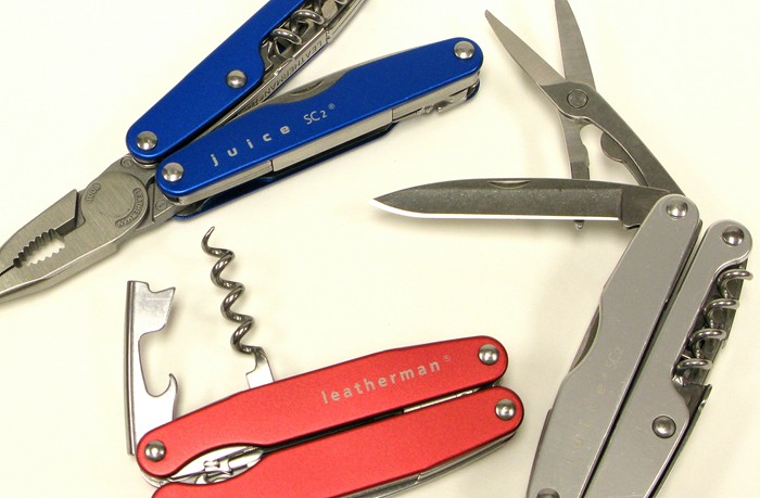

Blades and Tools
Outside opening
  • Plain edge knife blade, drop point profile, double side grind bevel. Measures 2-1/2" long. (60mm)
  • Scissors, backspring loaded. (*serrated section out near the tips)
  • Corkscrew
  • Combination corkscrew assist/bottle opener/can opener. (*note that from the factory, can opener blades on Juice tools are not sharp enough to open cans)
Inside opening
  • Medium flathead screwdriver
  • Small flathead screwdriver
  • Eyeglass screwdriver
  • Phillips screwdriver (square profile suitable for Leatherman Removable Bit Driver accessory)
  • Lanyard attachment ring
Blade characteristics
  • Note that the scissors, corkscrew, and corkscrew assist pivot from the opposite end of other Juice models.
  • Also unique to the SC2 is a black plastic bushing stop, located for the knife blade and scissors to rest against.
