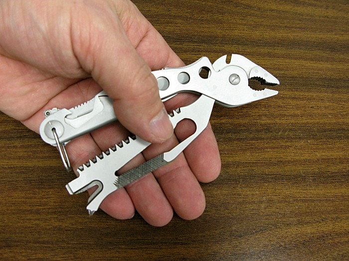

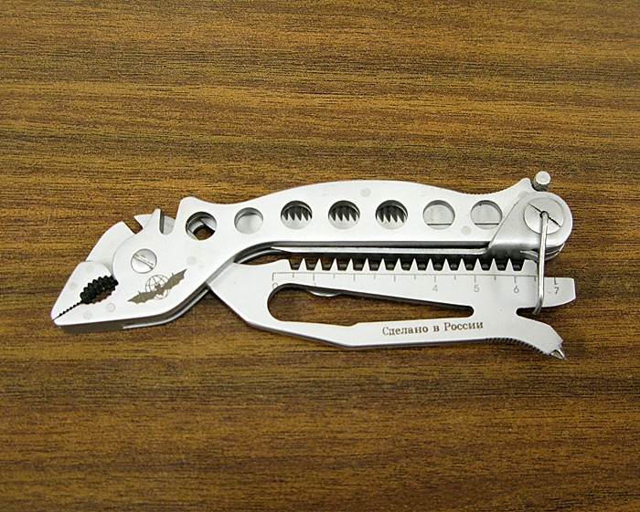

Noks Sapper Yet another unique tool from the East is the Noks Sapper. It has a unique appearance all its own, is packed with a remarkable number of features, and is built suprisingly well. Nevertheless, ergonomics and usability are not up to the standard most multitool buyers expect.

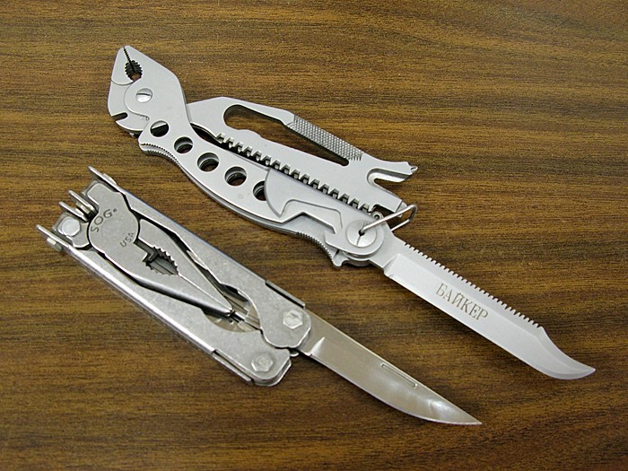

Knife Blade comparison with Paratool

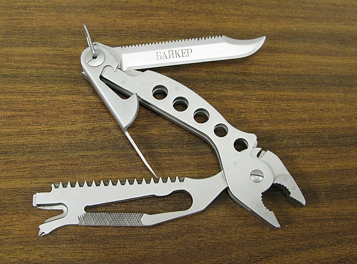

Can opener - Awl blade

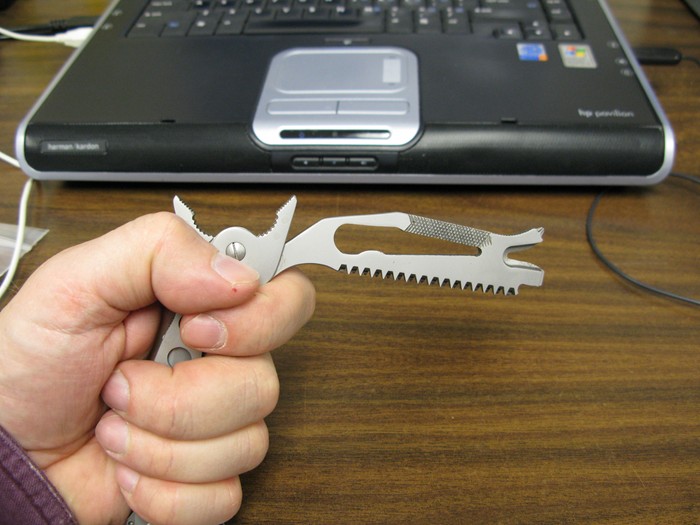

saw deployed for use
Plier Jaws
  • Jaw shape is an unusual blunt nose, with coarse and fine gripping areas
  • A wire cutter notch is located on the side of the plier pivot.
  • Finish is bead blast matte stainless.
  • Construction is of laminated steel plates, riveted together.
  • Jaws are held in the closed position by the locking bail.
Handles/Frame
  • Frame is constructed of laminated plates, riveted together.
  • Handle is one piece solid.
  • Crossholes are machined into frame for reduced weight.

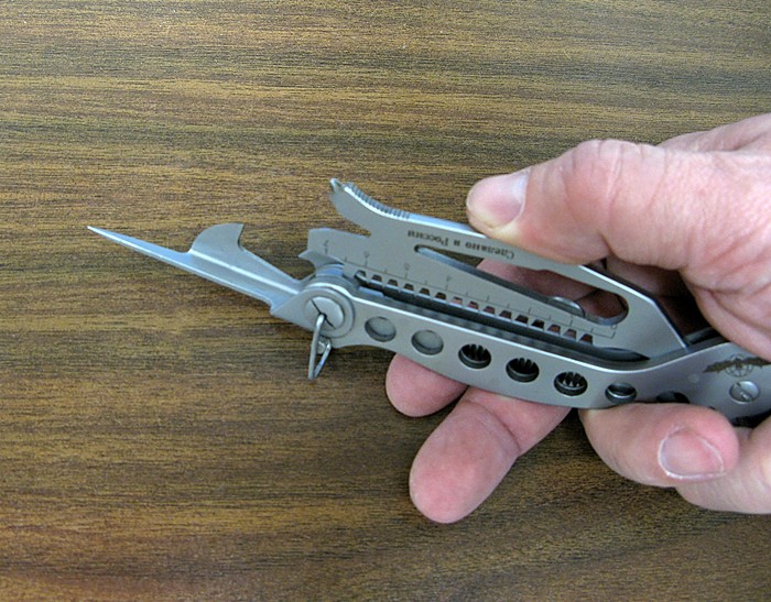

  • A metric ruler is etched into one side. It reads up to 75mm.
  • The Noks "bat" logo appears on the plier head. MADE IN RUSSIA is etched in Russian on the handle.
  • Many additional features are integrated into the plier handle. See details below.
Blades and Tools
  • Plain edge knife blade, with clip point profile
    • Measures 3" long (80mm)
    • Liner locking
    • Features a thumb stud for one-hand-opening
    • Has a coarse-toothed rasp cut into the spine and one side.
  • Combination can opener/awl blade
Locking Mechanism
  • The knife blade locks open via a standard liner lock.
Other Features

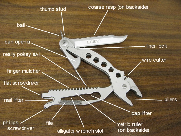

  • A large number of features are built into the plier handle, including:
    • Saw, double cut teeth (see picture)
    • Flat screwdriver
    • Phillips screwdriver
    • Cutout for prying nails
    • File
    • Cap lifter
    • Alligator wrench cutout
