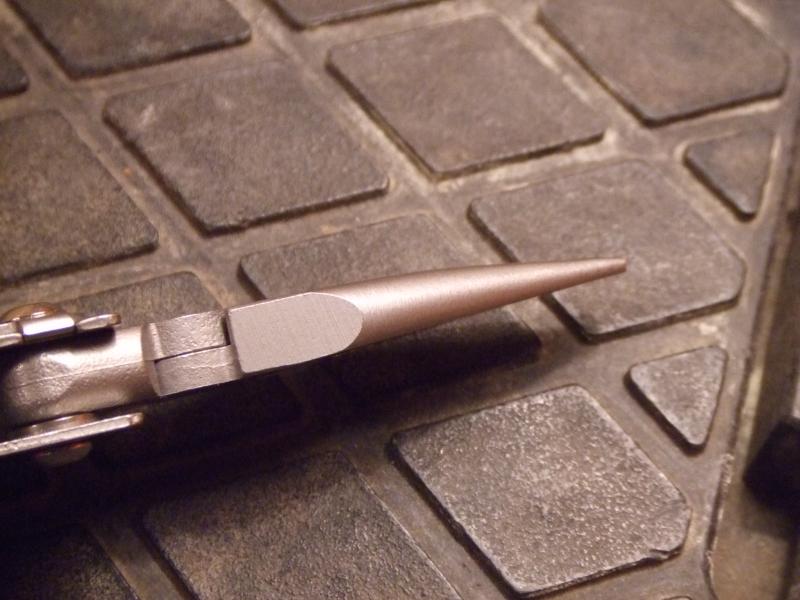

SideClip asymetrical jaws
asymmetrical jaws

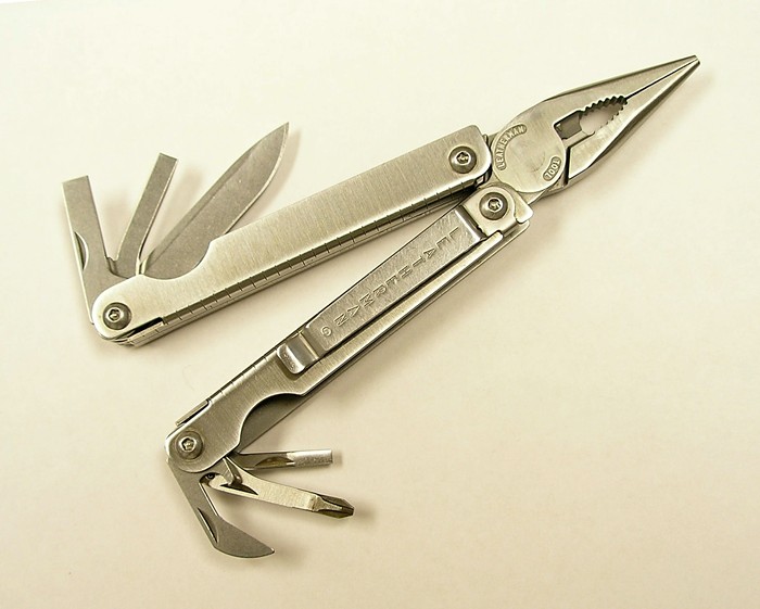

Early model

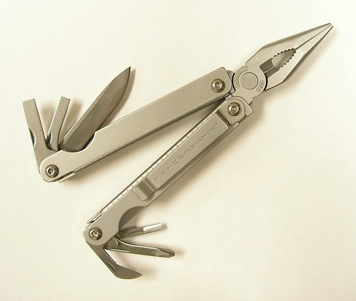

Later model

  • Jaw shape appears to be the same as those of the Leatherman PST. However, from the side you can see that one face of the jaws was ground back, making them much thinner than a standard PST's jaws. This also leaves the SideClip jaws asymmetrical, which in some situations can be handy.
  • Jaw features include fine serrations, a gripping area, and a wire cutter area. (With hard wire notch)
  • Early models had a bead blast matte finish. Later models were brushed stainless.

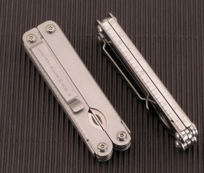

Handles/Frame
  • Each handle of the SideClip is comprised of two seperate halves. (Four distinct handle pieces are required to assemble a SideClip, each one slightly different). Also of note the Sideclip has four date codes due to the four piece handles.
  • Handle sheet metal on the SideClip is slightly thicker than the PST, making it more comfortable to grip under pressure.
  • A small cutout in one handle allows the Leatherman Tool Adapter to be attached.
  • LEATHERMAN SIDECLIP is stamped in large font on one handle, along with PATS PEND and PORTLAND OR in smaller font. Inch and metric scales are stamped along the spines of both handles.

Basically there are two variations of the SideClip; the Early model, and the Later model. Differences are as follows:
  • Early model
    • Bead blast matte finish all over
    • "Old style" plier head, with smaller pivot area
    • Shorter medium screwdriver, with nail nick
  • Later model
    • Brushed stainless finish all over
    • "New Style" plier head, with larger pivot area
    • Longer medium screwdriver, with nail notch on spine
