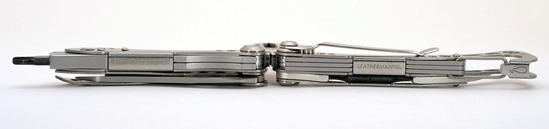

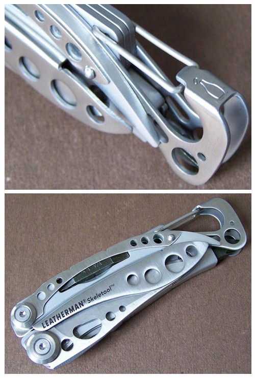

Skeletool beauty shot At first glance the Skeletool appears to be a radically new device for Leatherman, but in fact it incorporates several design features from earlier Leatherman products, including layered backsprings similar to the Juice line, the carabiner/bottle opener from their knife line, and a flattened bit driver similar to those found on the Wave and Charge tools. Designed with an eye towards minimum weight and maximum carryability, the Skeletool embodies the belief that a tool is no good unless you have it with you. As such, it offers both a pocket clip and a carabiner to encourage EDC.
Skeletool close-ups Skeletool close-ups

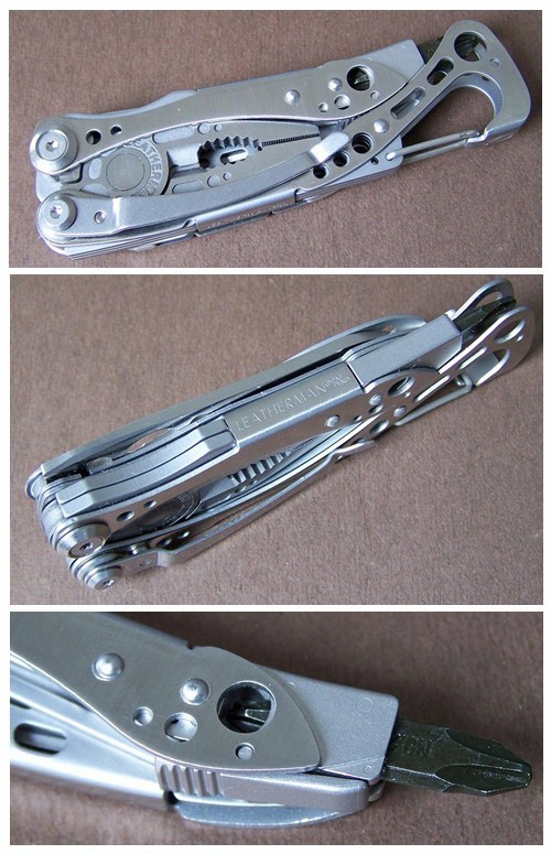

close-ups

Handles/Frame
Skeletool handles are perhaps more complex than that of any other multitool. Not counting rivets, the handles are made up of over ten separate components.
On the "carabiner handle" a skeletonized channel of sheet metal is wrapped around a stack of three backspring plates. Attached to that is a contoured piece of aluminum, containing a pocket for holding the spare screwdriver bit. The bit is held in place by yet another piece of sheet metal.
The ""bit driver handle" also consists of a sheet metal channel, this one wrapped around a stack of two backspring plates. Attached is another sheet metal channel, this one containing the knife blade.
Finish is brushed stainless all over.
There is no date coding on the Skeletool. sad

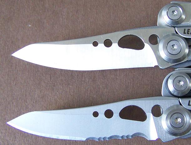

Blades and Tools
The only folding device on the Skeletool is its locking knife blade. The blade measures 2-1/2" long. (63mm) It is made from 420HC stainless.
A bit driver is mounted in one handle that accepts Leatherman's flattened hex bits. A spring-loaded locking tab prevents the bit from falling out during carry.

First year models (2008) will have a plain edged 420HC steel blade, while newer models (2009 and up) will have partially serrated 420HC steel blades. This change according to Leatherman was based on customer feedback and real world testing. This is valuable information for the collector as the Skeletool series does not have a date stamp as other Leatherman models do. The Skeletool is also available now in different colors (limited time probably) green, blue, tan and you can still get plain stainless steel. In 2017 REI Outdoors released a topographical graphics edition blade and black oxide frame of the Skeletool along side the Signal that are lasered etched on.
