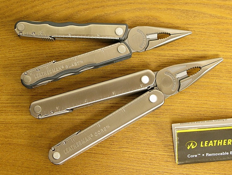

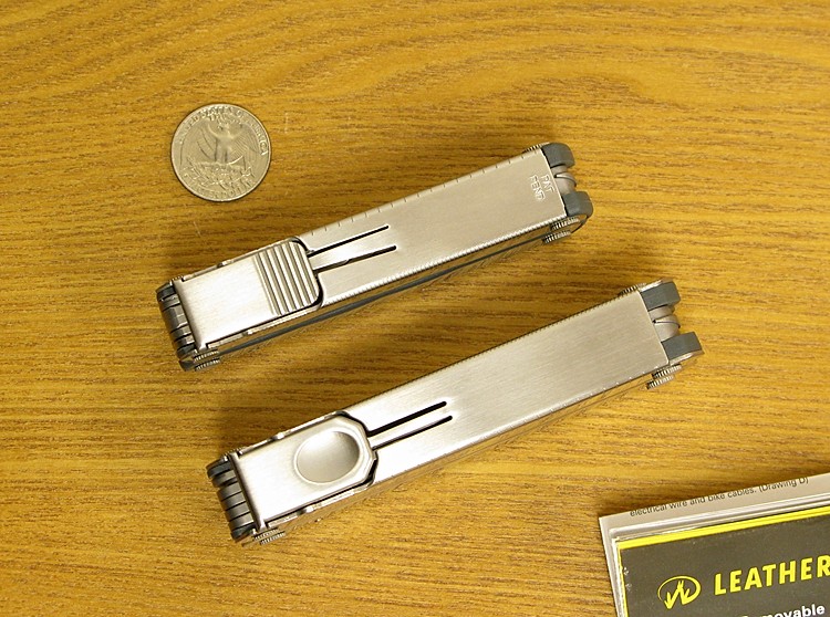

compared to Blast
Core
Blast (top), Core (bottom)

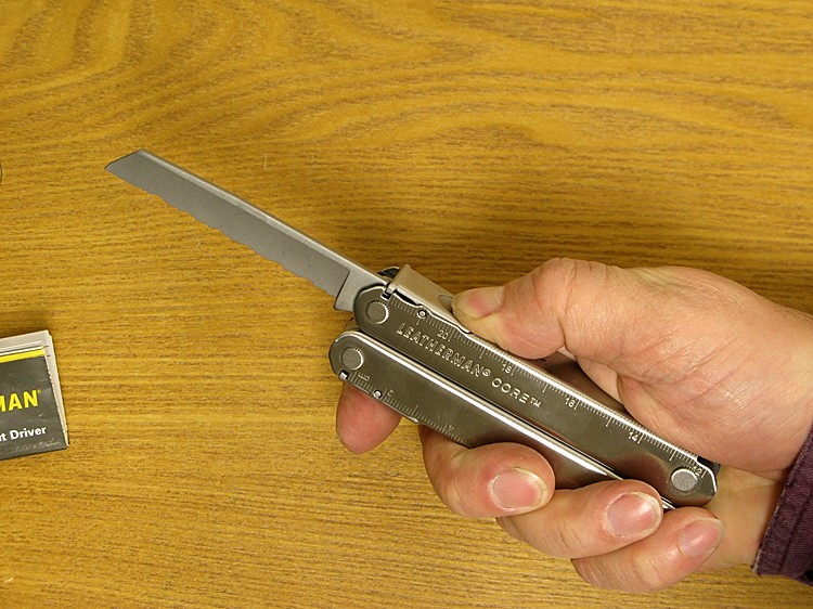

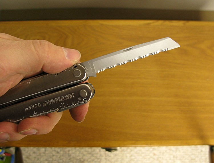

serrated blade

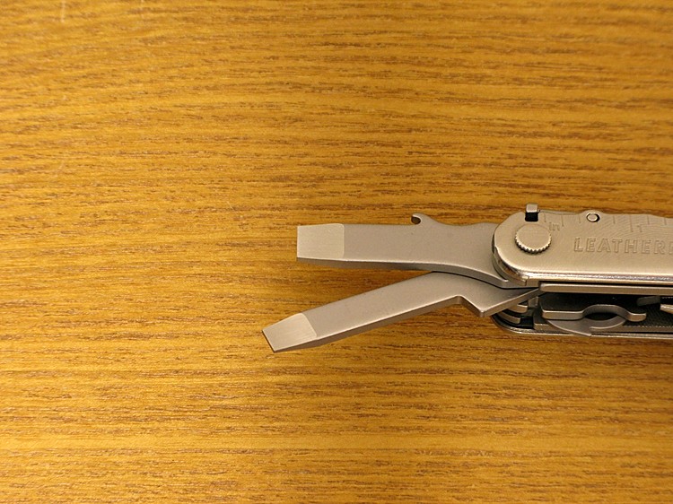

hollow ground screwdrivers

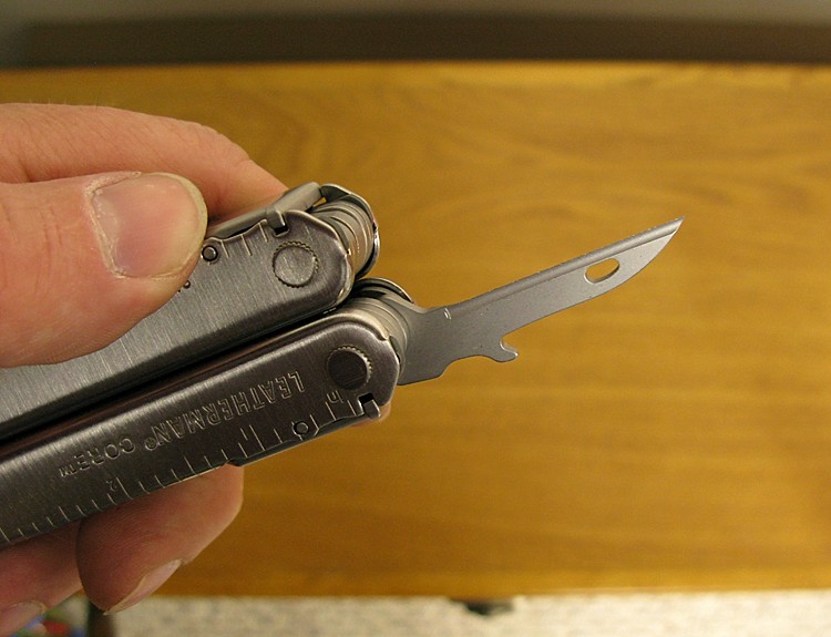

awl

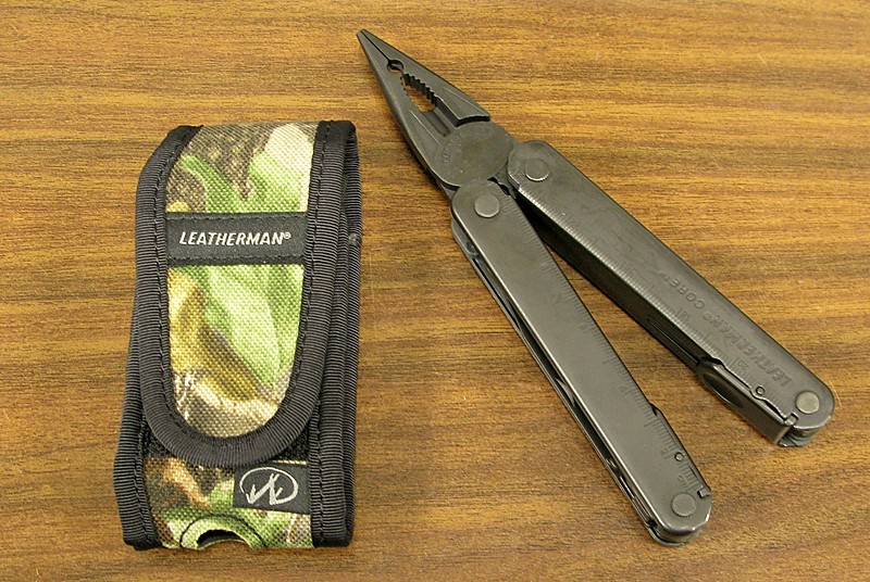

black oxide finish, cap crimper

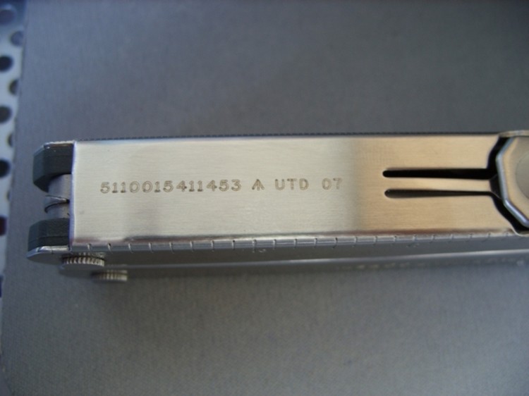

Nato Issue Core
NATO serial number

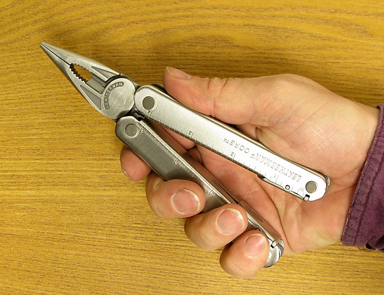

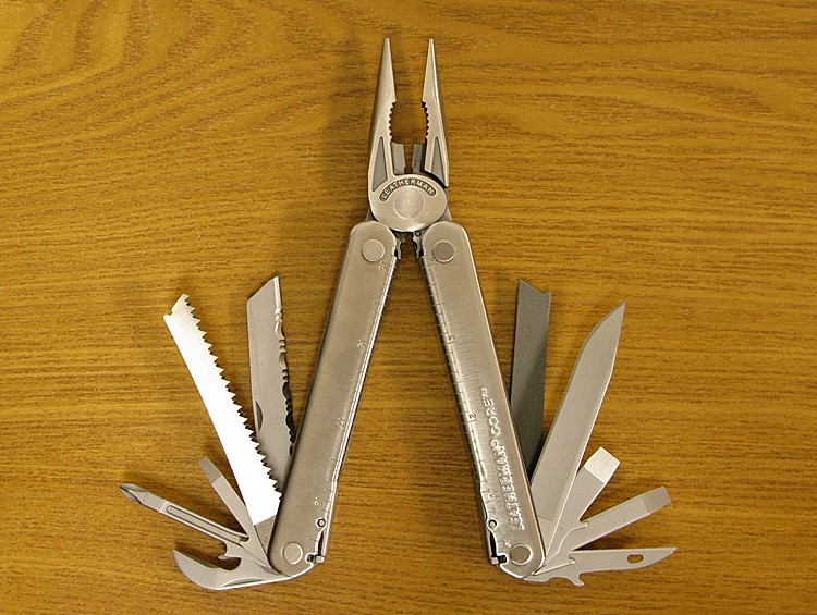

Tools Fanned
Plier Jaws
  • A new plier head was designed especially for the Core and the Surge. It employs the same elliptical pivot area introduced on standard-sized Leatherman's in 2004, but the entire head is scaled larger.
  • In addition, a stranded wire cutter is located on the underside of the pivot.
Handles
  • A generous wire cutting area is provided, as well as a hard wire cutting notch.
  • Like the Kick, Fuse, and Blast introduced a year earlier, the Core employs plastic inserts in each handle. Unlike its smaller brethren however, these inserts are not contoured for improved grip comfort. The rolled edges of the stainless steel itself are adequate for that. Instead, the plastic appears to do nothing more than act as a spacer.
  • Ruler increments are stamped into both faces. Inch measurements are on one side of the tool, metric measurements on the other.
Blades and Tools
  • plain edge knife blade, clip point profile, double side grind bevel. Measures 3" long. (75mm)
  • large flathead screwdriver*
  • medium flathead screwdriver*
  • awl (dished cutting edge, and sewing eye) see pic at lower right
  • lanyard ring
  • file, three toothed surfaces
  • serrated knife blade with sheepsfoot profile. Measures 3" long. (75mm)
  • can opener, with V-notch wire stripper
  • #2 phillips screwdriver
  • small flathead screwdriver*
  • saw blade
  • note all three flathead screwdrivers have an excellent hollow-ground profile. See picture at lower right

    • Camoflage nylon, with velcro closure and elastic accessory panels. Included with cap crimper version Cores. Also allowed for carrying tool in unfolded position, plier tips downward. See picture at lower right

  • Core tools issued to NATO troops have a serial number etched along one handle.
