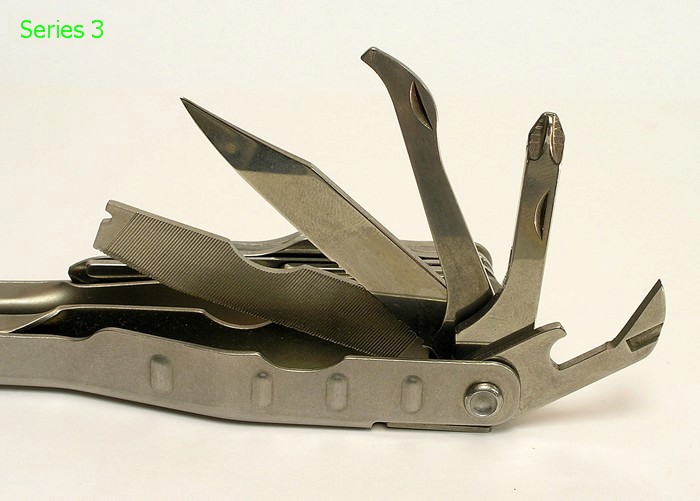

Series 3 tools have stiffener bumps on the blade locking tabs, both handles.

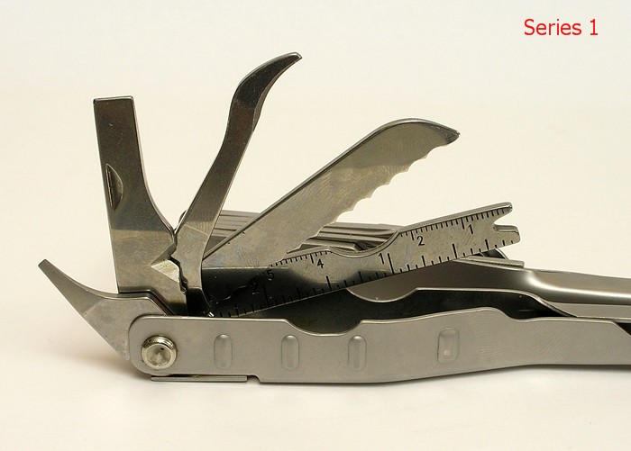

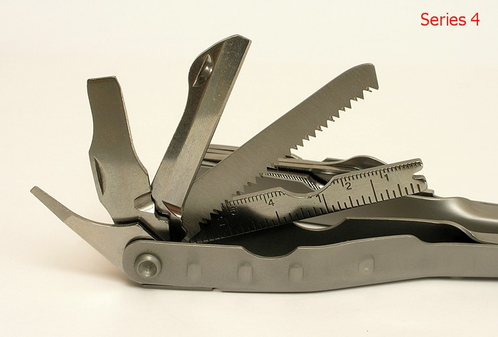

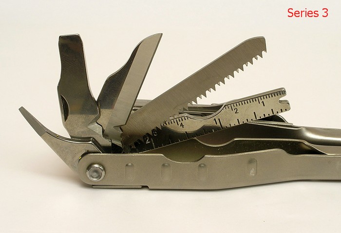

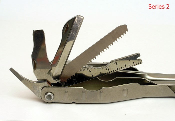

Blades and Tools, left handle
Series 1 blade selection was described on the main ST1 Tough Tool page. Blades in the left handle are as follows:
Left handle blades in Series 2 tools were slightly different. The can opener was given a shorter nail notch, the "hook knife" was brought over from the right handle, and the clip point knife was given coarser serrations.
From Series 2 to Series 3 the left handle blades were virtually unchanged:

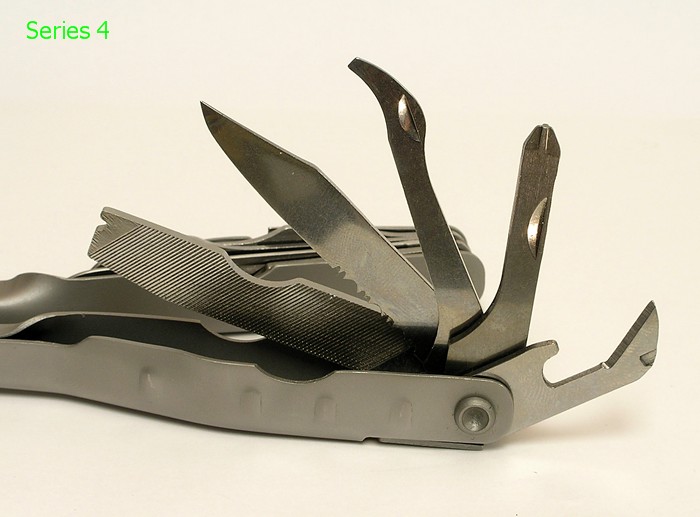

On the Chinese Series 4 tools a crude attempt has been made to imitate the American-made blades but the quality on all of them falls far short.

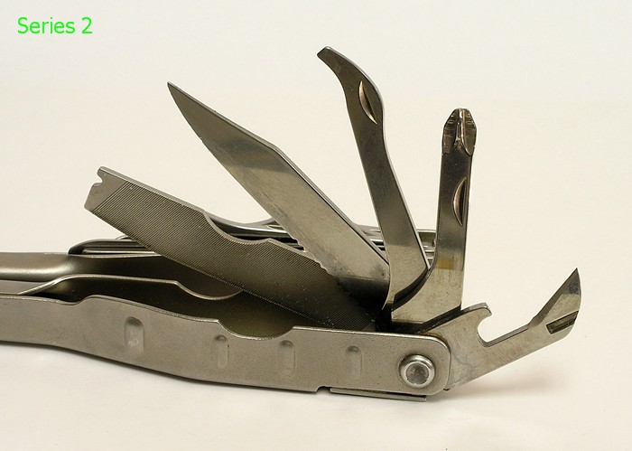

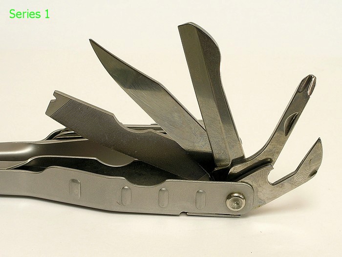

Blades and Tools, right handle
Series 1 blade selection was described on the main ST1 Tough Tool page. Blades in the right handle are as follows:
On Series 2 tools a sharp tooth saw blade replaces the serrated knife. The plain edge sheepsfoot is brought over from the left handle, and the shape of the large flathead screwdriver is changed somewhat. The small screwdriver is given somewhat more length.
The only change from Series 2 to Series 3 was the plain edge sheepsfoot blade. Note that this new blade is the same as used on the Schrade i-Quip and NaviTool.
Chinese Series 4 tools go back to a right-handle blade arrangement as used in Series 2. Note again however that these are just crude imitations of the originals.
