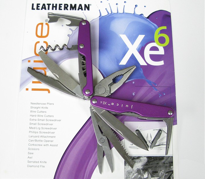

Juice XE6 The XE6 is the big daddy of the regular Juice line up. Its wide body houses one of each of all the blades and tools found in the other models. Only the specialty Juice Pro has more functions. And what exactly does the "XE" prefix stand for? Only the insiders at Leatherman know, and they're not telling.

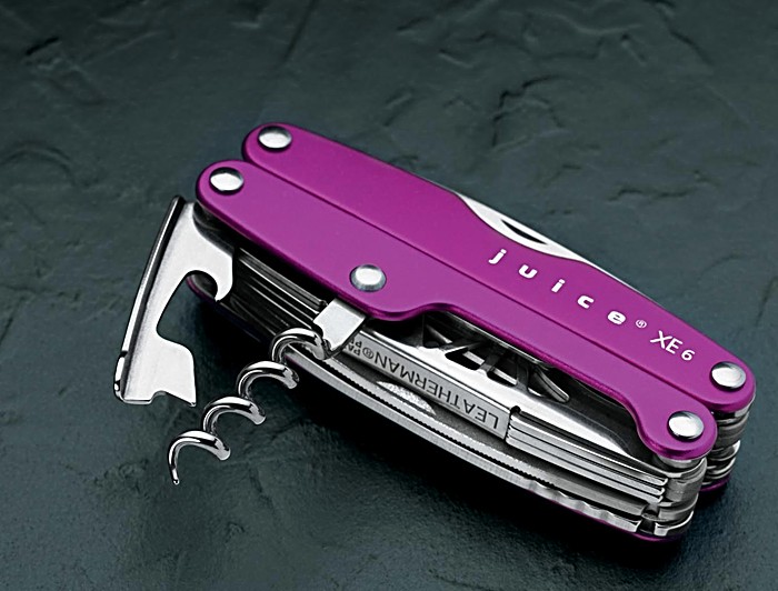

Corkscrew and Assist

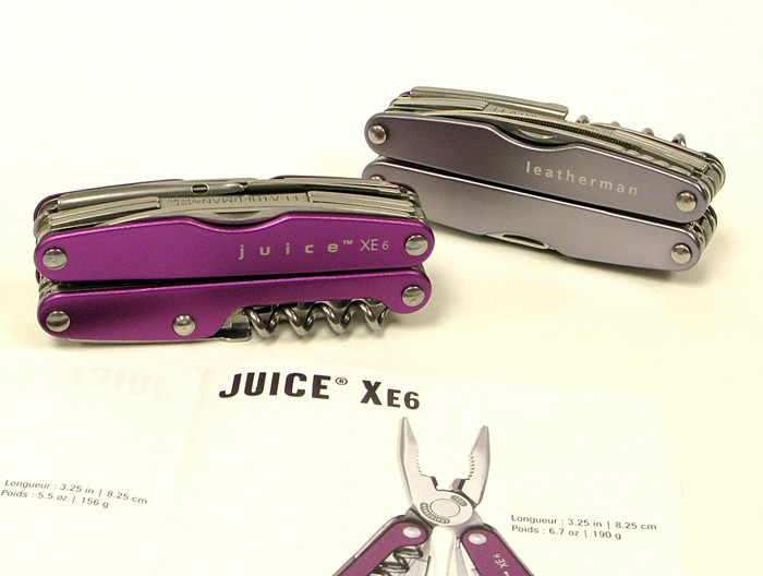

Thunder Purple and Storm Gray

  • Profile is semi-needlenose
  • Features include fine serrations, a gripping area, and a wire cutter area. (with hard wire notch)
  • Brushed stainless finish

Blades and Tools
Outside opening
  • Plain edge knife blade, drop point profile, double side grind bevel. Measures 2-1/2" long. (60mm)
  • Awl, with sewing eye (*note awl blades on Juice tools are not factory sharpened)
  • Saw blade, double cut (*awl blade must be opened in order to access saw)
  • Scissors, backspring loaded. (*serrated section out near the tips)
  • Corkscrew
  • Combination corkscrew assist/bottle opener/can opener. (*note that from the factory, can opener blades on Juice tools are not sharp enough to open cans)
  • Three-sided file blade, one face of which is a fine diamond.
  • Serrated edge knife blade, modified sheepsfoot profile. Measures 2-1/2" long. (60mm) (*notches on spine of blade help user identify this blade without looking)
Inside opening
  • Medium flathead screwdriver
  • Small flathead screwdriver
  • Eyeglass screwdriver
  • Phillips screwdriver (square profile suitable for Leatherman Removable Bit Driver accessory)
  • Lanyard attachment ring

  • The standard color offerings for the XE6 model are Thunder Purple and Storm Gray.
