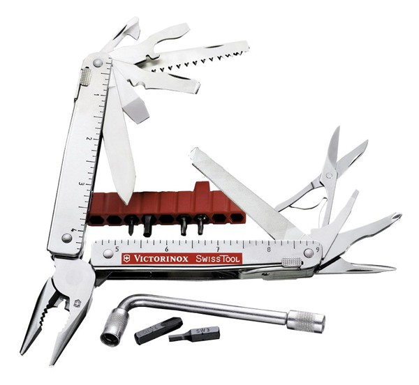

In addition to the original, there are currently three other variations of the SwissTool. The black oxide version is simply the original model with a black finish on all surfaces, including pliers, handles, and blades. The ))SwissTool(( "X" replaces the serrated knife blade with a pair of scissors, while the "RS" version replaces both the serrated blade and the file blade with scissors and a curved, serrated belt-cutter blade respectively.
Note that the "CS" model is not really a different variation, but simply the "X" model packaged with seperate bits, wrench, corkscrew, and eyeglass screwdriver.
