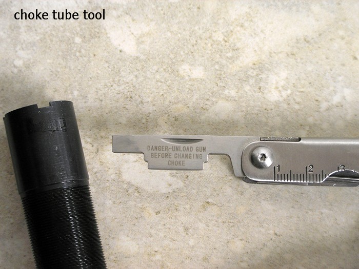

choke tube tool

  • Medium flathead screwdriver, with combination choke tube wrench for shotguns.

The Chinese model is stamped REMINGTON SPORTSMAN SERIES. It has a sharpened notch in one of the shears jaws, evidently to make bone cutting chores easier. There is also some warning text etched onto the choke tube tool.
