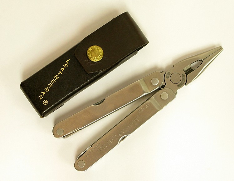

Super Tool Introduced in 1994, the Leatherman Super Tool broke new ground in the world of multitools. Not only was it larger and tougher than the competition, it also featured blades and tools that locked open, the first Leatherman to do so. Long a favorite of construction workers and tradesmen, the Super Tool remained in production until being replaced by the Super Tool 200 in 2001.

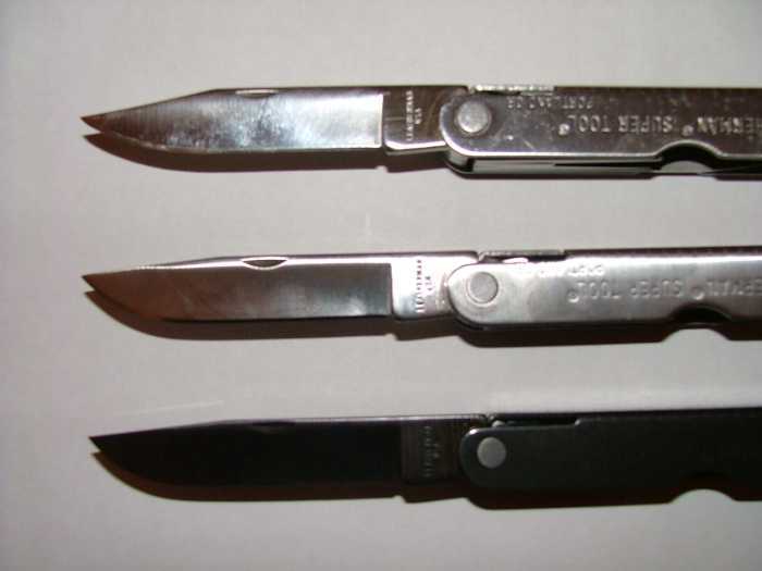

Super Tool knife blades
blade comparison courtesy of Dave K''

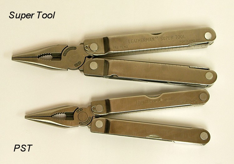

Compared to the PST

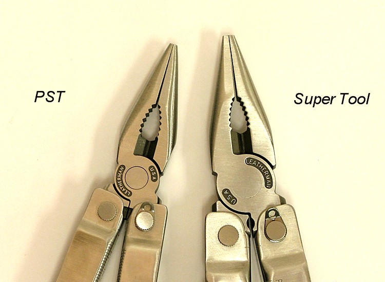

In most respects the Super Tool is simply an original PST that has been scaled bigger.
  • Folded, the overall length of an ST is 4-1/2" (115mm) versus a PST which is 4" (100mm)
  • Plier jaws on the Super Tool are much larger and stronger (see picture at right)
  • The Super Tool houses five blades and tools in each handle, compared to only four for the PST.
  • The Super Tool handles are made from heavier gauge steel than the PST. This makes the handles stronger, as well as more comfortable to use.
  • Larger pivot screws are used on the plier end of the Super Tool.
  • Super Tools were equipped with a hard wire cutting notch from the very start, whereas PST models did not include a hard wire notch until the mid-1990's

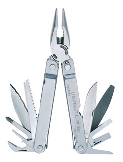

Blades and Tools
  • plain edge knife blade, clip point profile, double side grind bevel. Measures 3" long. (75mm)
  • awl
  • medium flathead screwdriver
  • large flathead screwdriver
  • file, three toothed surfaces
  • serrated knife blade with drop point profile. Measures 3" long. (75mm) (This is the first tool in the Leatherman line that had a blade of this type).
  • can opener
  • phillips screwdriver
  • small flathead screwdriver
  • saw blade (This was the first tool in the Leatherman line that had this type of tool).
  • Note that there were changes to the knife blade and file blade around 1997. More discussion of these changes can be found HERE on the Multitool.org Forums

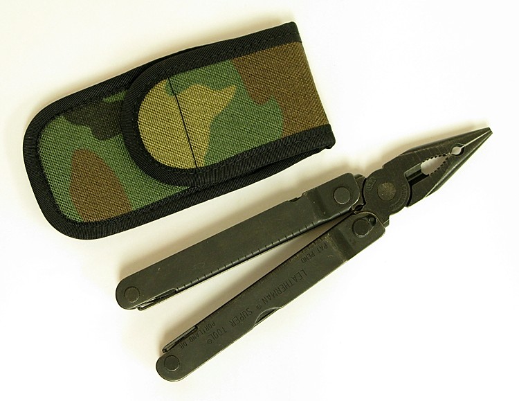

  • Heavy leather, with snap closure. Loop allows vertical carry only.
  • Nylon, with velcro closure. Vertical carry only.

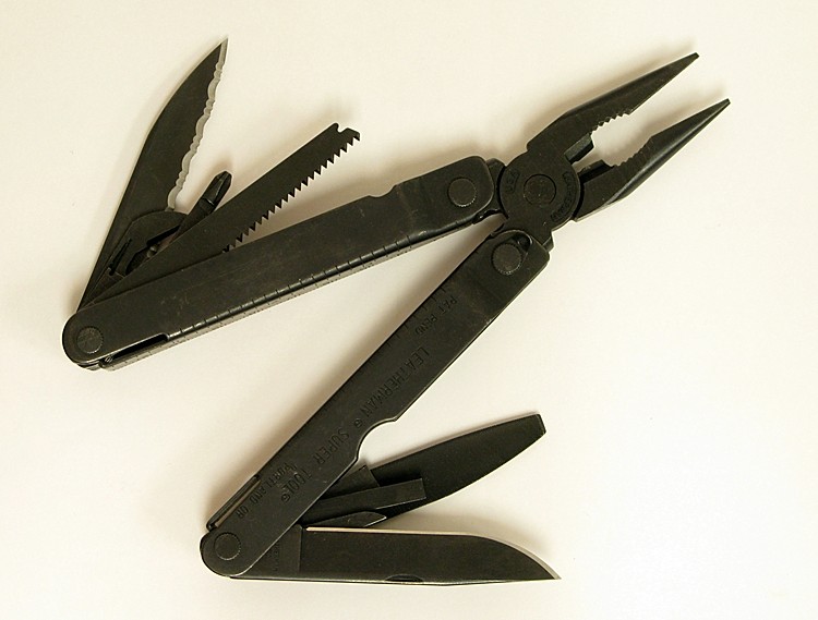

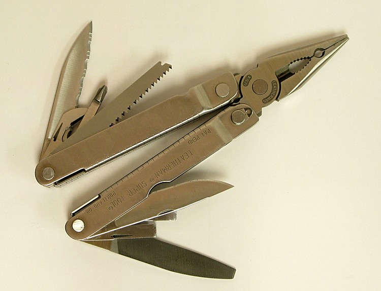

  • The Super Tool was produced in both stainless steel finish and black oxide finish. In addition, Cap Crimper models were offered in both finishes (photos at right)
