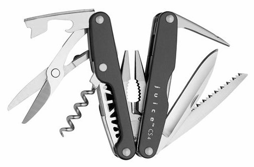

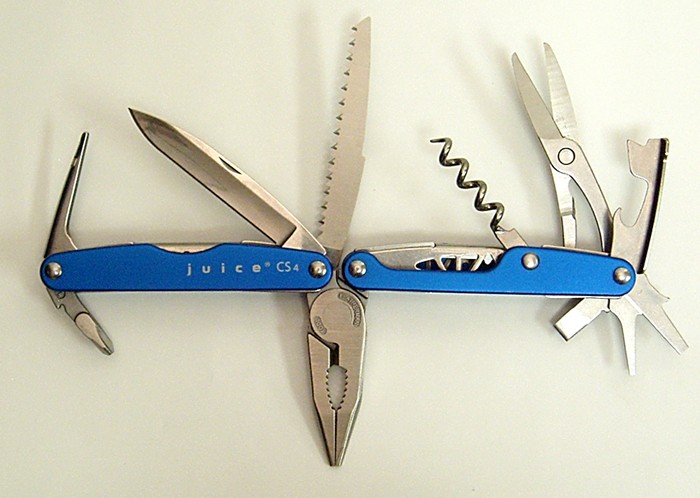

Juice CS4 The CS4 shares the same double-wide asembly as the KF4. (outside-opening blades are arranged on both sides of the plier head/screwdriver layer) This set-up allows for four long-blade layers, but makes it more difficult for some users to access the center mounted screwdrivers.

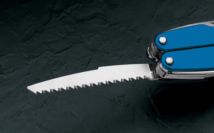

Saw Blade

Jaws
  • Profile is semi-needlenose
  • Features include fine serrations, a gripping area, and a wire cutter area. (with hard wire notch)
  • Brushed stainless finish

Blades and Tools
Outside opening
  • Plain edge knife blade, drop point profile, double side grind bevel. Measures 2-1/2" long. (60mm)
  • Awl, with sewing eye (*note awl blades on Juice tools are not factory sharpened)
  • Saw blade, double cut (*awl blade must be opened in order to access saw)
  • Scissors, backspring loaded. (*serrated section out near the tips)
  • Corkscrew
  • Combination corkscrew assist/bottle opener/can opener. (*note that from the factory, can opener blades on Juice tools are not sharp enough to open cans)
Inside opening
  • Medium flathead screwdriver
  • Small flathead screwdriver
  • Eyeglass screwdriver
  • Phillips screwdriver (square profile suitable for Leatherman Removable Bit Driver accessory)
  • Lanyard attachment ring
