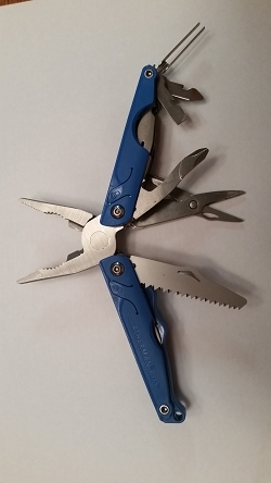

Leap.png The Leatherman Leap is a tool that is meant to be a kids first multitool. Leatherman has designed this tool to be smaller for a childs hand. It comes in bright colors and even has a knife blade that comes separate so the parent can install it later when they feel the child is responsible enough. With or without the blade the Leap is a great multitool. So great that even an adult could carry this tool and find it to be very useful.

  • Needlenose/regular pliers. Bypass cutter with a hard wire notch.
Handles/Frame
  • The outside part of the handle is plastic or rather a Glass-filled Nylon (in either blue, red, or green) the inside frame is stainless steel.
Blades and Tools
Needlenose Pliers
Regular Pliers
Hard-wire Cutters
Wire Cutters
420HC Knife (optional, can be put on later)
Saw
Spring-action Scissors
Ruler
Tweezers
Bottle Opener
Phillips Screwdriver
Medium Screwdriver
Small Screwdriver
Blade Characteristics
  • All the tool are polished stainless steel. Only the longer tools lock(knife, saw, Phillips driver and scissors). The rest are non-locking.
Locking Mechanism
  • The knife, saw, Phillips driver and scissors have a liner lock but the rest of the tools are non-locking.
Sheath
  • The Leap doesn't have a sheath at this time.
