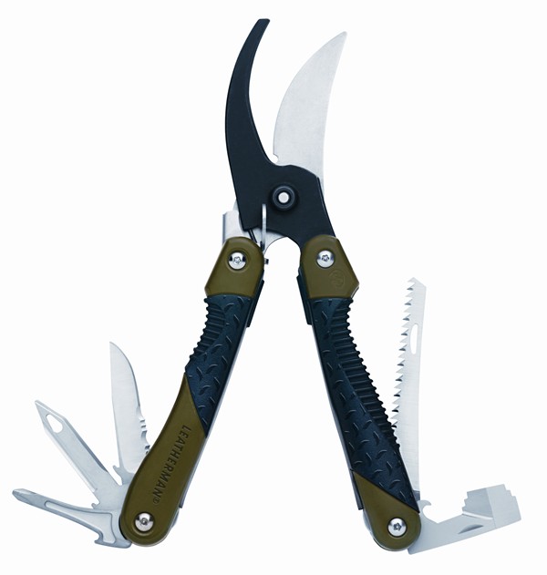

Leatherman Vista Along with its stable mate Hybrid, the Leatherman Vista represents somewhat of a departure from the companys traditional offerings. Instead of pliers, it is based on a large set of folding pruner jaws. (secateurs) Also unusual are the green plastic handles and soft rubber grips. The Vista was designed as a hunting/outdoors multitool, and has a number of features included specifically for that purpose.

The pruner jaws on the Vista are of the bypass type. (as opposed to the anvil type) Jaw opening is such that branches up to 3/4" (20mm) will fit between them. There is also a soft wire cutting notch at the base of the pruner section.
The jaws are spring-loaded by means of a hidden clothespin spring. A thumb activated safety lock bar holds them in the closed position when not in use.
Handles/Frame
The Vista's handles have an underlying frame made from stainless steel, formed into a U-shaped channel. Attached to the steel is a contoured set of scales made from high impact green plastic. Overmolding the green plastic are inlays of soft black rubber, positioned where the hand would normally grip. Despite being an inside-opening style tool, the Vista is not uncomfortable to squeeze hard on.
Blades and Tools

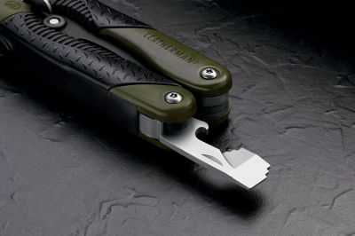

One handle houses a long wood saw blade and a combination flathead screwdriver/cap lifter/choke tube wrench implement. (see picture below)
The opposite handle includes a very large awl, a Phillips screwdriver, and a knife blade. The knife blade is 2-1/4” long (57mm) and has a combination straight edge/serrated edge profile to it. The User's Guide suggests that the large awl can be used for starting screw-in tree steps.
