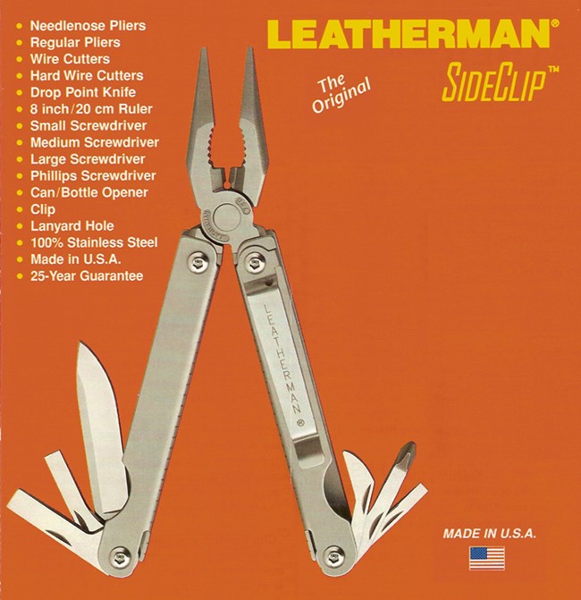

Judging by the interest and high prices used ones fetch on eBay, a person could rightly conclude that the SideClip was years ahead of its time. Compared to the then-standard PST it featured a thinner profile, lighter weight, and did away with the need for a bulky sheath by including a handy pocket clip. It was the minimalist's multitool long before minimalists realized they needed one.

Jaws
  • Jaw shape appears to be the same as those of the Leatherman PST. However, from the side you can see that one face of the jaws was ground back, making them much thinner than a standard PST's jaws. This also leaves the SideClip jaws asymmetrical, which in some situations can be handy.
  • Jaw features include fine serrations, a gripping area, and a wire cutter area. (With hard wire notch)
  • Early models had a bead blast matte finish. Later models were brushed stainless.
Handles/Frame
SideClip asymetrical jaws
asymmetrical jaws
SideClip
handles and pocket clip
  • Each handle of the SideClip is comprised of two seperate halves. (Four distinct handle pieces are required to assemble a SideClip, each one slightly different)
  • Handle sheet metal on the SideClip is slightly thicker than the PST, making it more comfortable to grip under pressure.
  • A small cutout in one handle allows the Leatherman Tool Adapter to be attached.
  • LEATHERMAN SIDECLIP is stamped in large font on one handle, along with PATS PEND and PORTLAND OR in smaller font. Inch and metric scales are stamped along the spines of both handles.
Pivots
  • The SideClip featured button head screws for pivots instead of the traditional Leatherman knurled screws. Drive was 5-star Security PLUS Torx, also seen on the original Wave introduced the same year.
Blades and Tools
  • Plain edge knife blade, drop point profile, double side grind bevel. Measures 2-1/4" long. (55mm)
  • Medium flathead screwdriver
  • Large flathead screwdriver
  • Can opener
  • Phillips screwdriver
  • Small flathead screwdriver
Blade characteristics
  • None of the blades lock open.
  • Like almost all multitools of this era, the blades tend to clump when opening.
  • All blades are given a high polish.

Background
Introduced in 1998. Made in the USA. Discontinued in 2004. Replaced by the Kick.
The SideClip is related to the PST and shares a number of features and blades with it. The Kick with it's zytel handles and removable clip was the replacement for the Sideclip.
