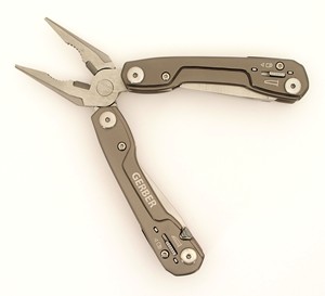

Jaws
Plier jaws on the Resolve are spring loaded. They come together and contact each other properly out at the tips. There are fine serrations near the nose, a gripping area below that, and a wire cutter area near the pivot.
Somewhat unusual is the fact that the wire cutters are anvil type, as opposed to the more common bypass type wire cutters on multitools.

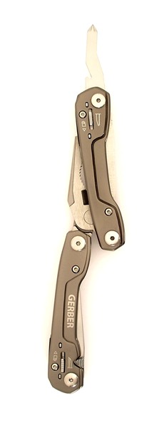

Handles/Frame
Each handle on the Resolve is formed from two halves of cast stainless steel. The handle halves are then given a titanium nitride coating for scratch and wear resistance.
The word GERBER and several tool icons are etched into each face. Nowhere does the name "Resolve" appear on the tool.
Due to a surprising number of spacers between individual knife blades, handles on the Resolve are quite thick, a trait some users find undesirable.
