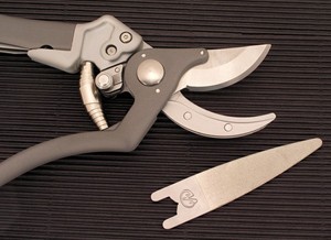

Jaws
The cutting jaws consist of two slabs of precision ground and hardened stainless steel. The lower jaw is riveted to the aluminum frame. The upper jaw is held in place by pins, and is easily removeable for sharpening or replacement.
In addition to the razor sharp pruning edges, there is a soft wire cutting notch in near the pivot.
